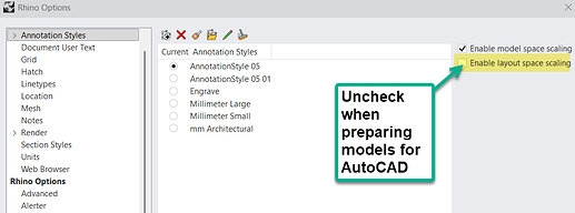

Here is the issue. Rhino uses its own advanced scaling for the layouts is called “Layout Space Scaling.” When that is enabled on the document in Options → Annotation Styles, any value in the annotation style like text and arrow height and many other, are scale to be 1:1 on the layout.
(If text is created 2.5mm high, it will be displayed on the layout 2.5mm high regardless of the detail scale.)
AutoCAD has a different and more complicated way of doing this called _Annotation scaling_ _and_ Rhino does not support this, but uses the above method. So what can you do?
The best way to make a model in Rhino that imports to AutoCAD correctly is to go to model space, is to uncheck the “Layout Space Scaling.”
 ![image](https://global.discourse-cdn.com/mcneel/uploads/default/original/4X/f/9/a/f9a9e20387e2b916bfda1ecb6eb020adfb001f7c.png)

_Uncheck_ the Layout scaling, and the model will look like it does when exported to Dwg:
 ![image](https://global.discourse-cdn.com/mcneel/uploads/default/original/4X/d/7/1/d71ac7c0092211f877e4ff963ff2eeda7386256f.png)

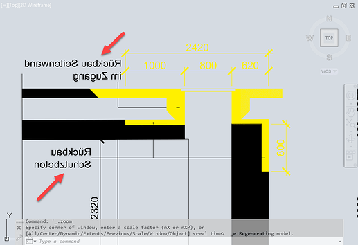

One additional issue is your mirrored text. [Here are details of why and how you can fix this](https://wiki.mcneel.com/rhino/faq/acad-mirrored#the_solution).
Again, there is a feature that Rhino has called “read text forward” and AutoCAD does not have.
So we have to turn this **off** in Rhino, can make sure the text looks correct with this off. If it does, then you are ready to export.
 ![image](https://global.discourse-cdn.com/mcneel/uploads/default/original/4X/0/9/8/09808ff1d2b7c813f4e28bb80f518d6a959e42fa.png)
