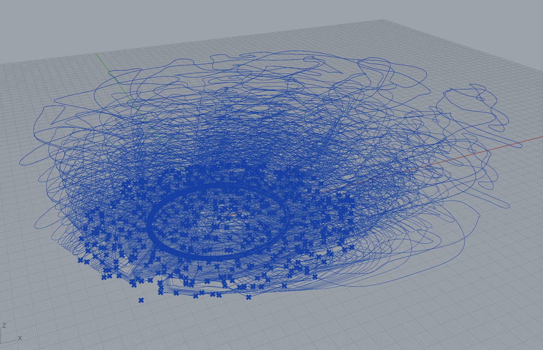

I’m doing this project from the video in the link below using Grasshopper as a way of learning. I did everything exactly like the video but it’s not working and I can’t identify my mistake. Could someone help me identify the mistake I’m making?

put a dam after Kangaroo so you can play freely
It seems it works better with a 1e-3 damping
Reset
begin with a circle radius of 0 then increase it slowly
when OK stop Kangaroo tool
Then click on Dam
Then suppress one of the wire so you have 11 geometry and 11 angles

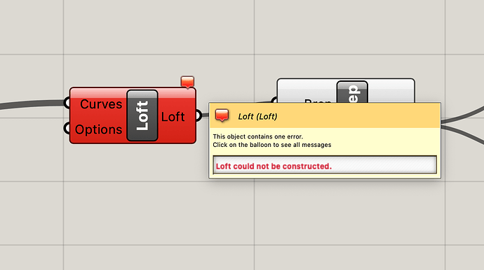

Unfortunately it didn’t work for me, an error appeared in a component.

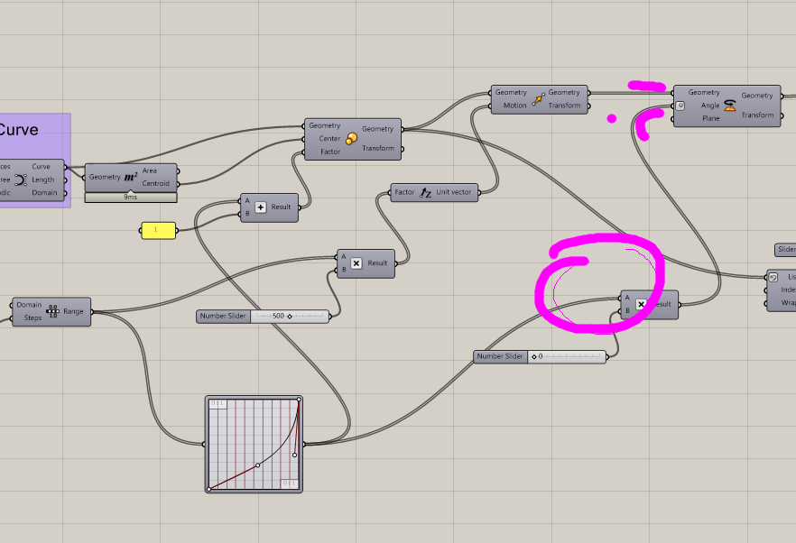

20250706_GH.gh (28.0 KB)
Probably solved by now. Yesterday evening at first test, I saw that changing the numberslider to higher numbers had positions without the error.
So probably the divider put points on “error” positions.

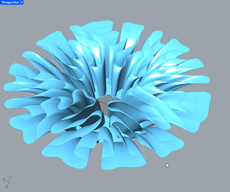

Hello
What type of function is used to prevent the curves from crossing over each other? Is this process complex for someone learning to use Grasshopper?
