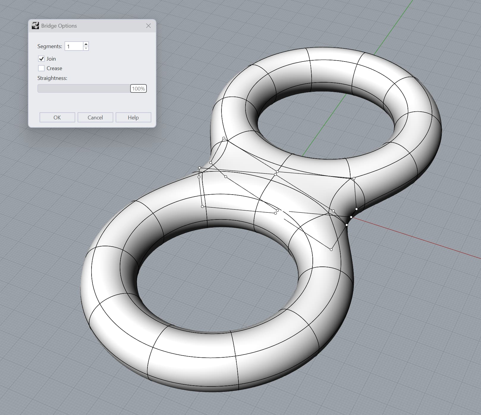

Draw two tori and union them or use SubD and bridge a few faces…
Won’t this result in a polysurface? I want to create a single surface with history that I can point edit. The actual shape I’m building is based on a double torus, but needs to be significantly transformed.

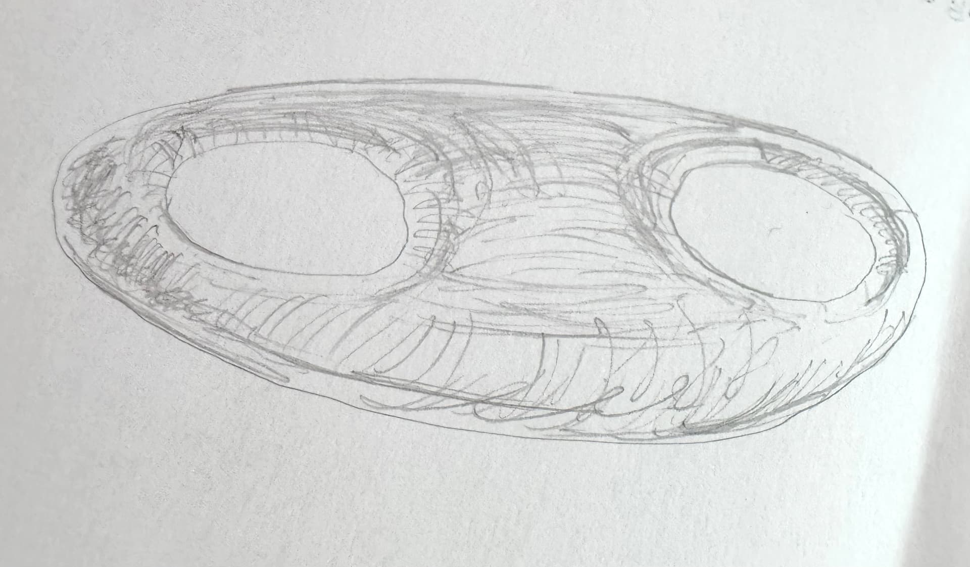

A sketch might help to explain your concept…

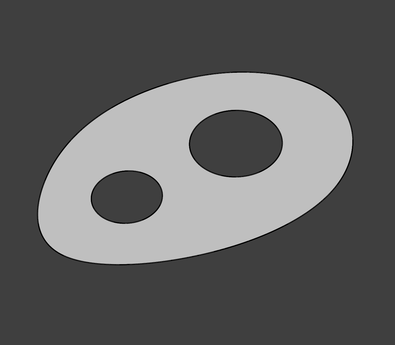

A figure-8 won’t do it. I’m thinking of something like this:
And why do you need one single surface?
It’s a workflow preference. In my experience, this makes iterations faster and cleaner.

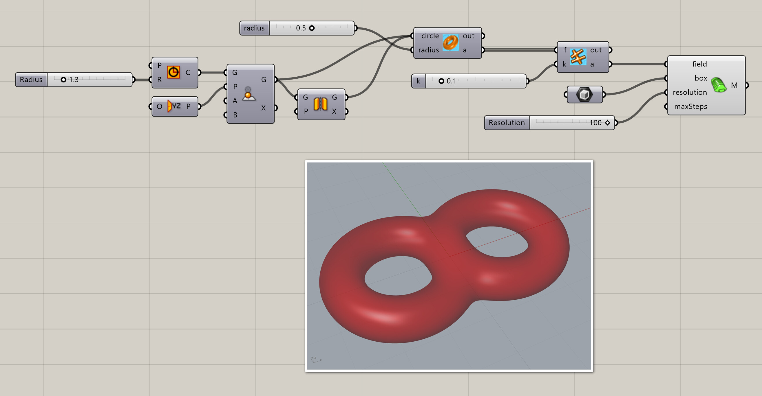

an other aproach -if you are familiar with the math would be implicit surfaces? :
-no controlpoints here… controlpoints are explicit :wink:
double-torus-isopod.gh (17.1 KB)
yes…
but what i meant was the option to define a shape by typing an equation. possible with a custom field in isopod
you would than modify the resulting shape by tweeking the numbers you feed the equation…
The isopod surfaces are interesting, but I suspect tweaking the equation inputs will take me an infinitely long time to get right.
The form will not remain symmetric and is very organic, which is part of why I’d like to be able to control point edit.

I know the genus only gives a general idea of a form with two handles. The rough sketch I submitted above is pretty close, but looks more symmetrical than the final version will be. It also has more contours than as drawn. I was hoping for a single-surface way to build this, but I see that it’s not executable.

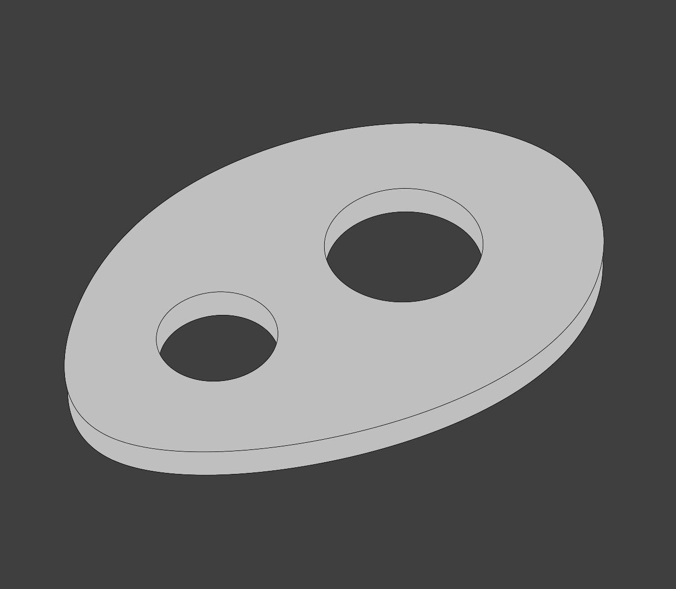

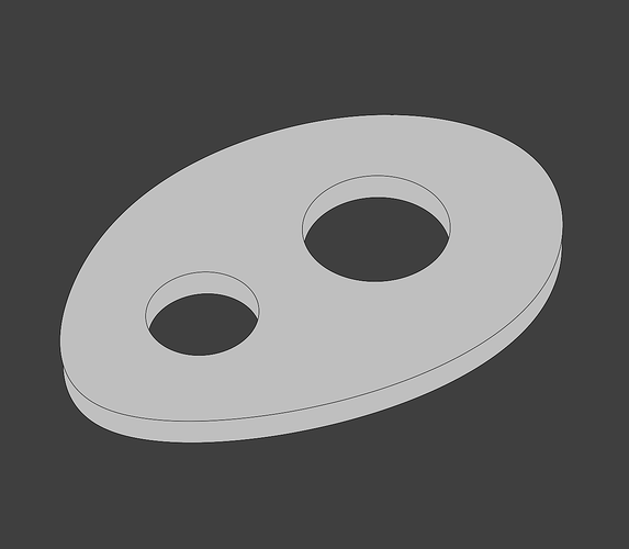

i doubt that torturing yourself and others to create a complex figure that is impossible to do with on single NURBS surface is going ot make your workflow any faster..
Rhino based on math does not mean that you can identify an untrimmed Nurbs Surface with two holes.
a single torus is still possible but a double torus would have to create intersecting regions. math applications or grapher like the grapher from MacOS actually use mesh to display the surfaces, which does not have the inherent restrictions NURBS do.

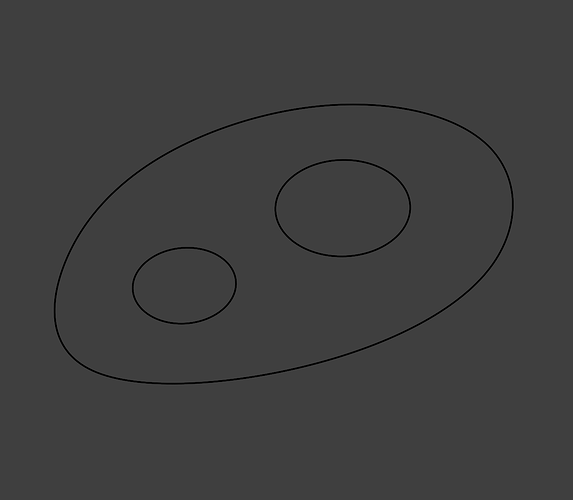

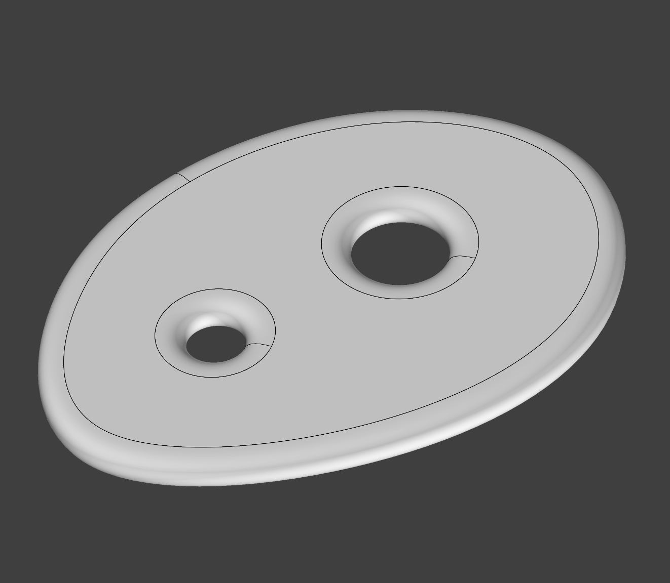

so in that sense creating a single surface NURBS double torus which has to have 4 sides is simply not possible. you can maybe get away with trimmed surfaces. there are many fast ways to create the exact model you like.
a fast method might be: create your planar curves - PlanarSrf - duplicate surface and move - BlendSrf to create your round edges.
