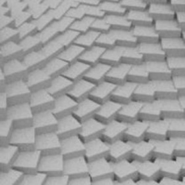

But of course, these are possible today within Rhino:
Can’t seem to find anything about it anywhere. That Piker stuff is cool, thanks!
