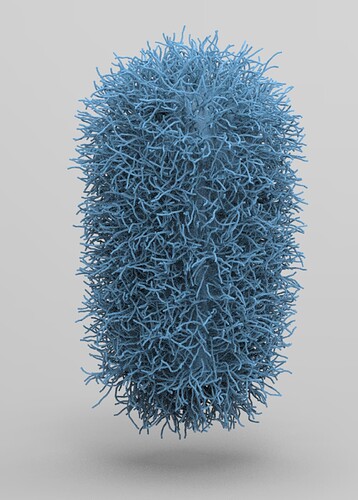

Not sure what the purpose is but if it is solely for display purpose, you might want to try Keyshot.
This here is a material called “Plastic Rug Blue Fuzz”
There are a lot of settings you can tweak…
You can also use something like that
