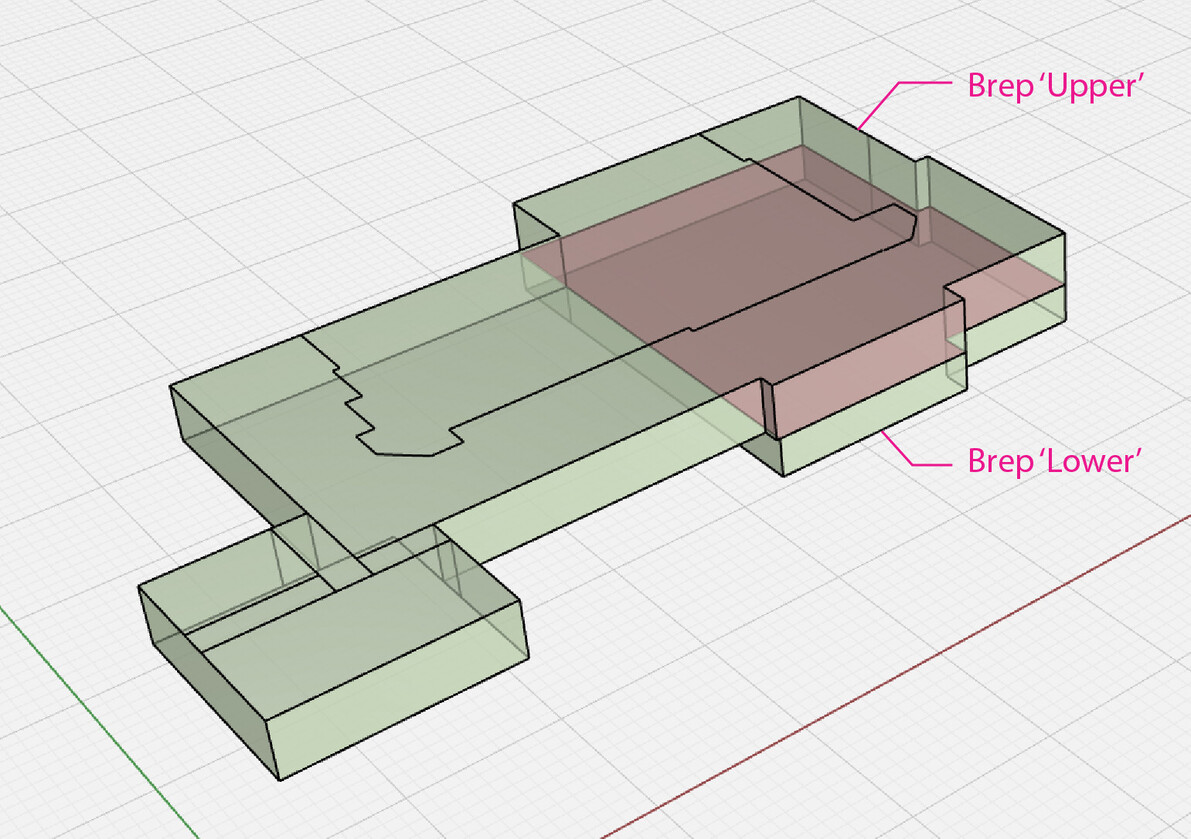

I’m trying to locate an intersection face between two irregular shaped, closed polysurface breps. They are both funny shapes, but I’ve been super careful to subdivide the faces so they should match perfectly. I’d like to be able to find this inbetween face using GH:
So just going through and testing face vertices for equality to find this face. But sometimes it seems to fail to find coincident vertices, and then sometimes it works ok? In GH, if I use the ‘native’ Grasshopper ‘Equality’ component to try and evaluate vertex equality, it gives me a different set of results than if I use the Rhino.Point3d.Equals() method?
using ghpythonlib.components.equality() gives me all the vertices I’d expect in this case (9) but then using Rhino.Point3d.Equals() only finds 5 vertices?

So I don’t really understand what I’m doing wrong here or whats happening to give me these different results in these cases? I’ve tried adjusting the ‘tolerance’ in Rhino / Properties / Units but that doesn’t seem to have any effect one way or another? Can anyone maybe shed some light on whats happening here and how I can model properly to avoid these issues in the future? This is just one small bit of geometry from a larger model and I’m seeming to have these ‘mismatch’ issues a lot (like, a lot a lot), but always rather unpredictably? Can’t seem to get a handle on whats causing this or how to avoid it.
Is there some other ‘tolerance’ value that is being used someplace for the GH equality that is different that the Rhino.Point3d.Equals() tolerance?
Any help would be much appreciated! Rhino and GH files attached here (Rhino 7)
thanks for any advice!
