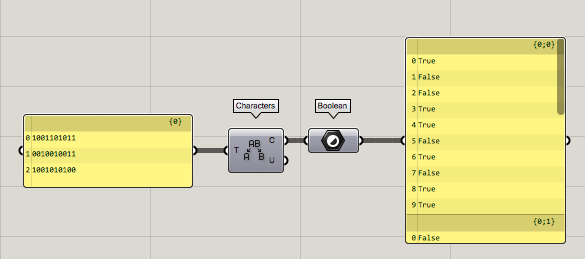

Essentially, I’d like the script user to be able to directly ‘type’ the panel circled below, without having to use the entwine component which requires the user to add a new input panel per floor
(qythium) #2
Something like this?
Or perhaps this:
Not sure if I understand your intention - also it’s better to attach minimal versions of your files:
(Nathan Stuckey) #3
@qythhium - YES! That character-boolean solution is genius; thank you so much!
