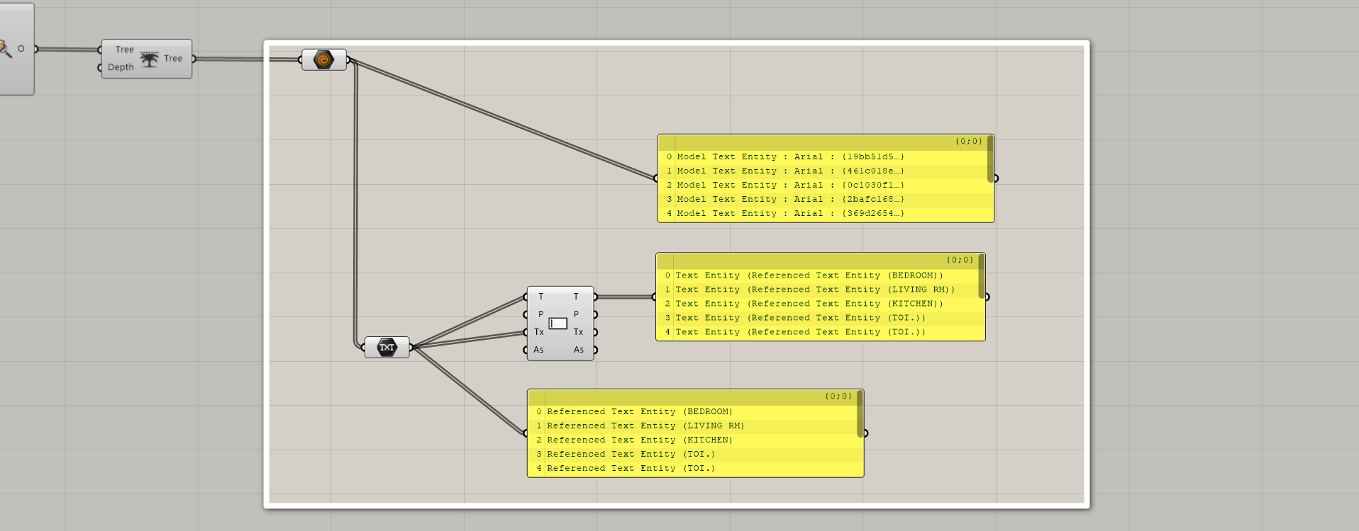

Difference between model text entity, text entity & ref text entity
what is difference between this three. and through this how can i get text directly and operate them
Model Text Entity: Uses Rhino 8 model object class. This means you can store User Text, Layer, Visibility, etc parameters on it.
Text Entity: None of the above are included. It is plain geometry.
Referenced Text Entity: This is same as Text Entity but it exists in the Rhino Model and not in Grasshopper. If you internalize it then it becomes Text Entity. You can convert Referenced Text Entity into a Model Text Entity if you put it in a Model Object.
