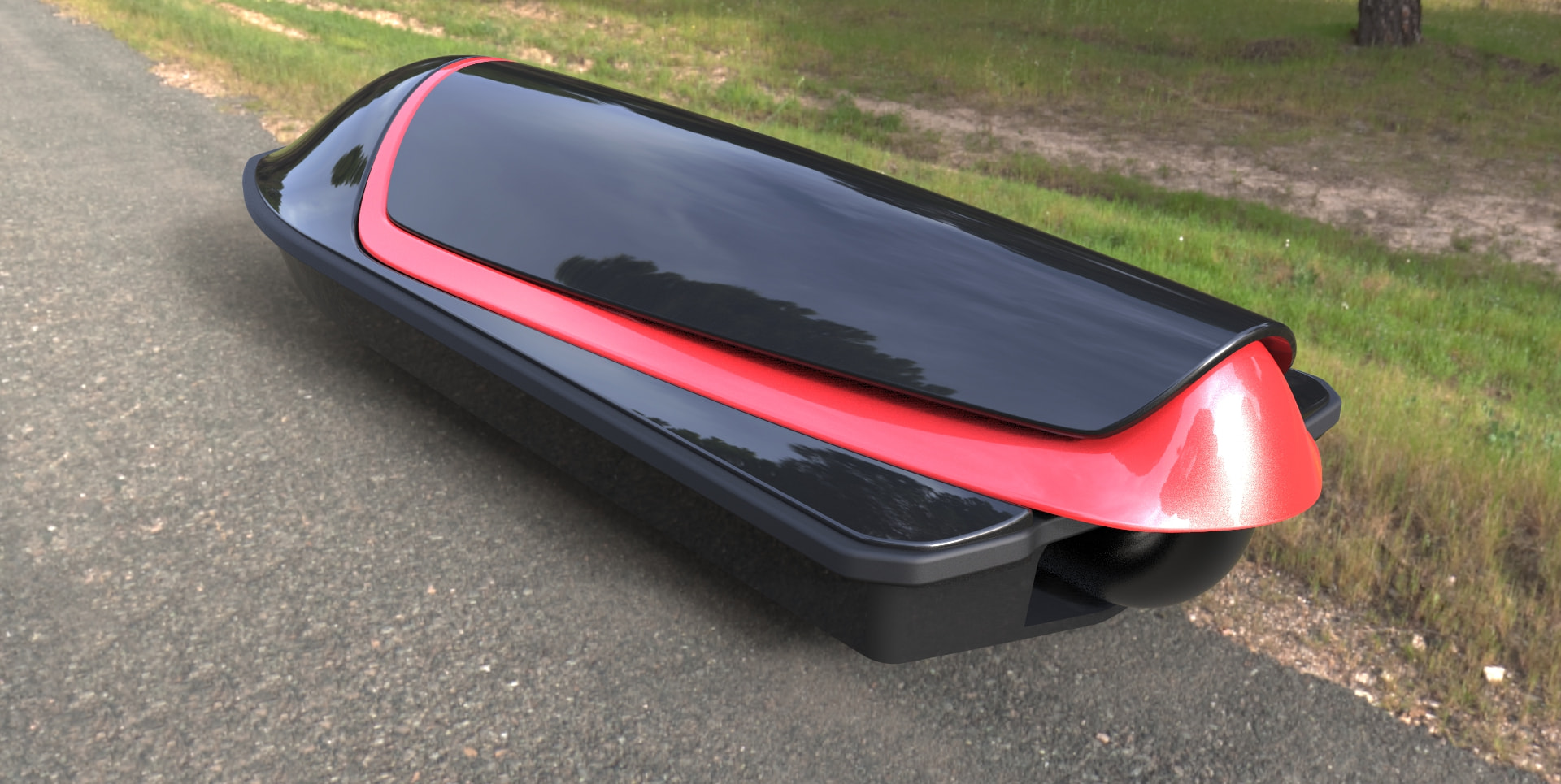

The Powerplant, floating thrust pump pod...
The original plan was to build a custom pod, to be cool, and sleek, and expensive.
