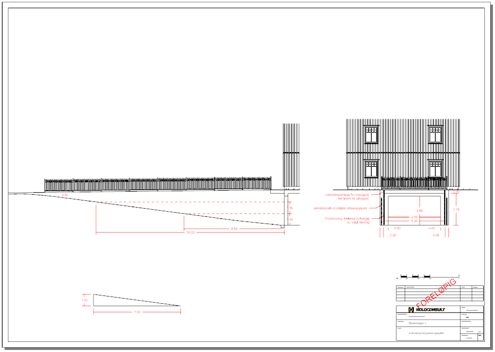

Details: How: Same text size in model as in detail?
I need to have some text in the model, and I need that text to keep the real life scale when I make a detail, but the detail scales the text size. Is this possible?
Example:
This data is used in multiple details and also as references when modelling:
But when I add a detail it looks like this:
And visa versa, when I make an illustration in the model and add the dimensions it has to look like this:
For it to look like this in the detail:
Am I doing something wrong?
