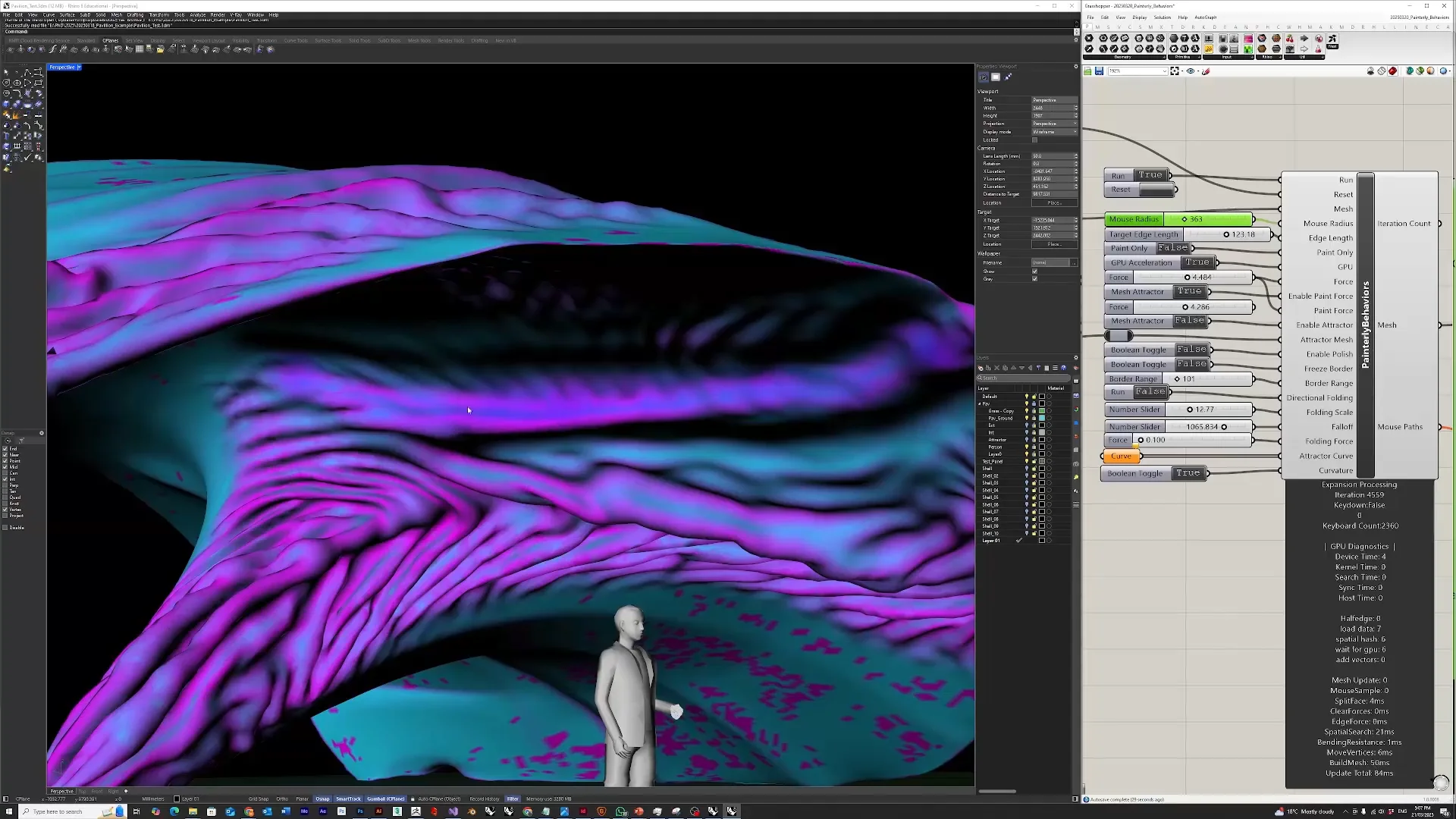

In Grasshopper there’s a component called RemeshByColor…. Could be useful
I will check this out, thank you :slight_smile:
Was this in relation to ReduceMesh? Or the idea of increasing intensity in low intensity areas?
-Jeremy
It can be used for both things.
You can see high density on the head, medium density on the body and coarse in the crotch.

May I ask how did you configure the input to RemeshByColor to achieve the high density on the head, and lower elsewhere?
I’m thinking of how this could be paramaterised over a large landscape; and the faces recoloured from black to white as an input to that component.

I used points and a distance threshold to define vertex colors from black to white. The resulting black to white color gradient is the important input for Remesh by Color.
You could also use mesh curvature to extract zones of higher detail. Many options
