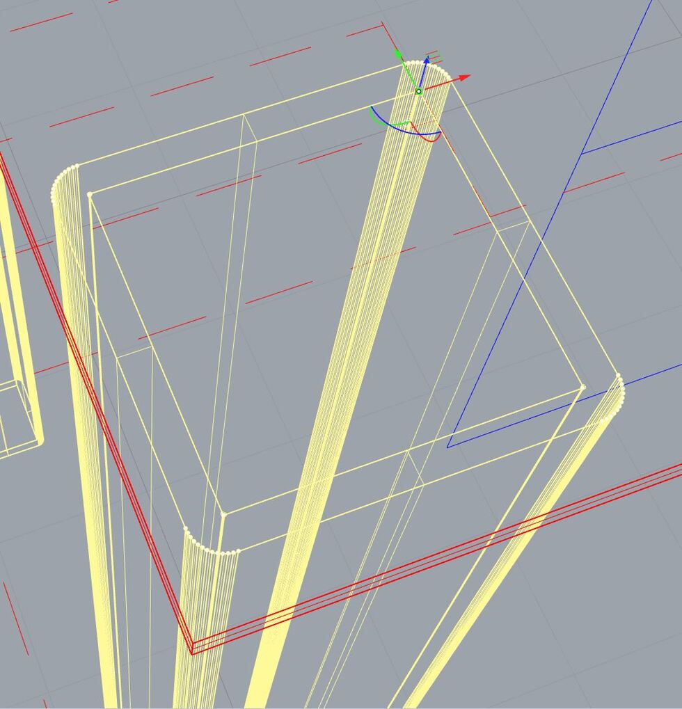

This object is a solid polysurface forming a long square sectioned hull-type tubel. I want to delete all faces but the outside and cap the ends so that it’s a long box instead of a long tube.
IN the below image I’ve secleted all the points forming an inside vertex. When I hit delte, nothing happens. It’s not on a locked layer. It’s not a great object because it’s not nurbs but facetted faces. (It’s an import from sketchup.)
Hello - ExtractSrf the top and bottom faces, delete these and the inner part then Cap the remaining part.
Thanks Pascal. Can you tell me why it’s resistant to simply deleting points? I don’t recall an object being resistant to that.
Hello -SolidPts are never ‘deleteable’ Curve control points are (minimum two) and EditPts are, mesh points are deleteable and surface points are, by rows only, down to a minimum of four - two in each direction.
