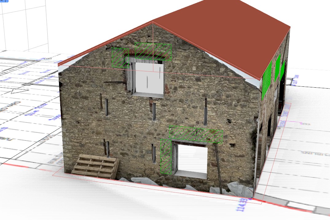

The context of the question is I have done a survey of an existing building that needs repair. I’ve modelled the building into Rhino/VA but need to add a single photograph on each side of the wall so that I can indicate areas that require attention.

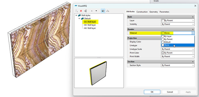

Hi @steve14 if you create a wall style with different layers, you can assign a material to each one of the wall layers.
You may need to create a material with the photo as a texture, with the same dimensions as the wall face.

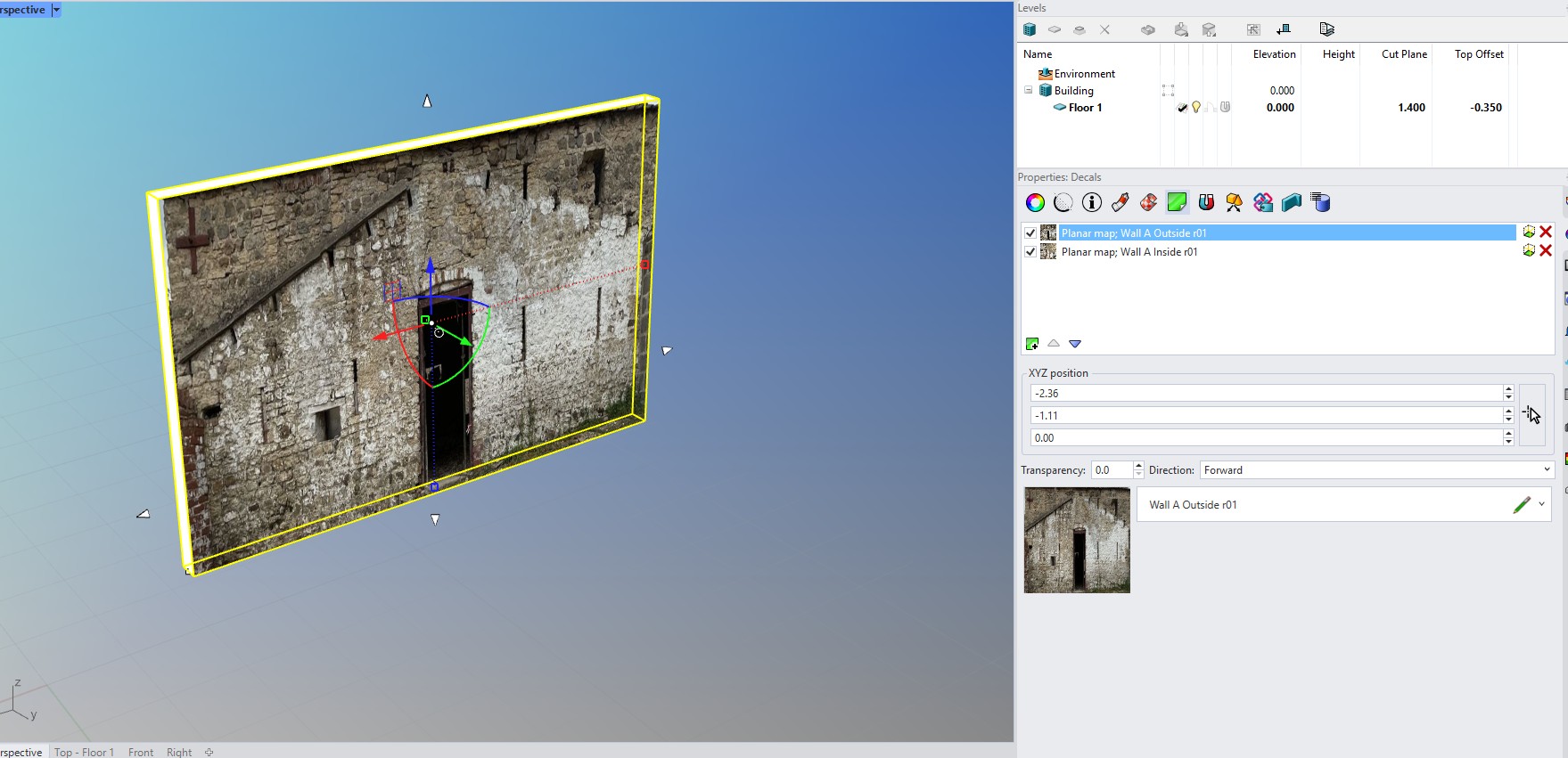

Hi @steve14 you can still apply decals on VisualARQ objects without the need to explode them. Isn’t it working for you?
You can put a different picture on each side of the wall if you like, just need to add a decal and rotate the widget.

Thanks Francesc, I shall bear that in mind. I enclose a clip of how the work flow ended up. I’d surveyed the building using the Matterport service so I was able to get a panoramic image of each wall surface. This was then applied as a decal to the exploded wall, after which I could mark it up. It wasn’t perfect but it enabled me to convey the idea to a contractor.

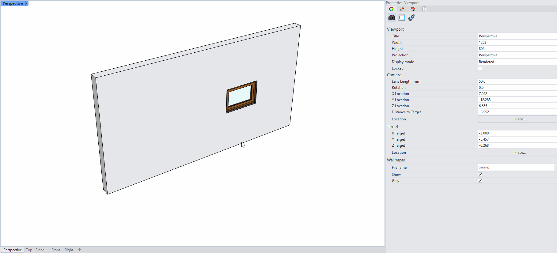

To answer your question I started a clean file this morning with just a single generic wall.
  1. Clicked the wall, went to properties:decals, imported one image file,
  2. chose “vertical” from the Rhino command line,
  3. clicked the bottom left corner of the wall,
  4. the bottom right corner of the wall
  5. then the top right corner of the wall and the decal appeared just as I needed.
  6. Did the same on the other side.
So there was no need to explode the wall after all. I’ve no idea why the original file would not allow the same process. The effect I was getting was that at 5. nothing would appear.
Hi @steve14 I’m glad to know you made it work without exploding the wall. Perhaps you had the osnap “Project” activated in step 5, when you couldn’t do it? anyway, if you have problems with this again, just let me know.
