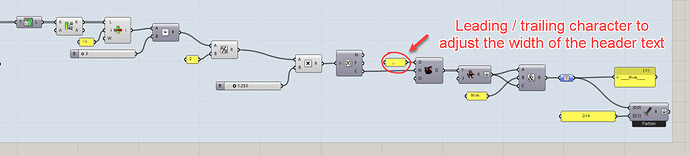

It looks like the Data Tables headers don’t accept leading or trailing spaces either.
That’s a bummer because I wanted to use a silly trick to adjust the width of the columns using the header lengths, but make sure the data in the cells will always be readable.
Using the cell width sometimes hides the headers, so I figured I’d adjust the text of the header based on the max length of the texts in the cells.
Ideally, the width should be set automatically to the widest of the two (Header / cell).
I tried the ASCI 255 “nbsp” character, and it doesn’t work either.
