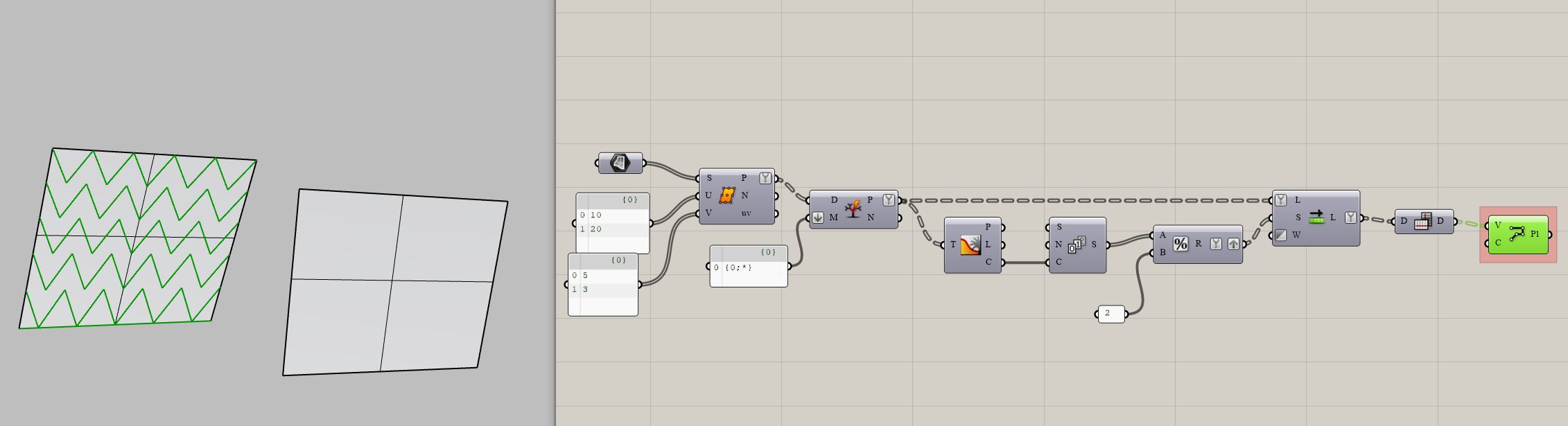

Totally Missed the Zigzag, Thank you for pointing it out , here are the issues I found with your definition.
1- Simplify is a destructive tool, It removes some branches that are sometimes needed downstream, so try to avoid it if necessary.
2- since your tree gets more complex. flipmatrix doesn’t work either, so use Path mapper.
3- Match tree is your friend, so use it more.
You can have as many surfaces as you can, I just forgot to cull the last polyline since it doesn’t have a zigzag pattern
