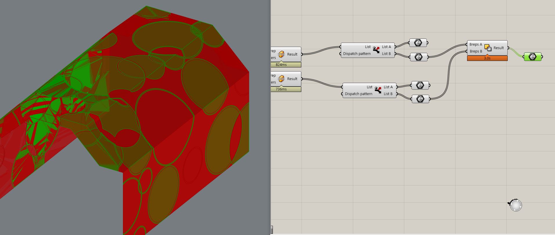

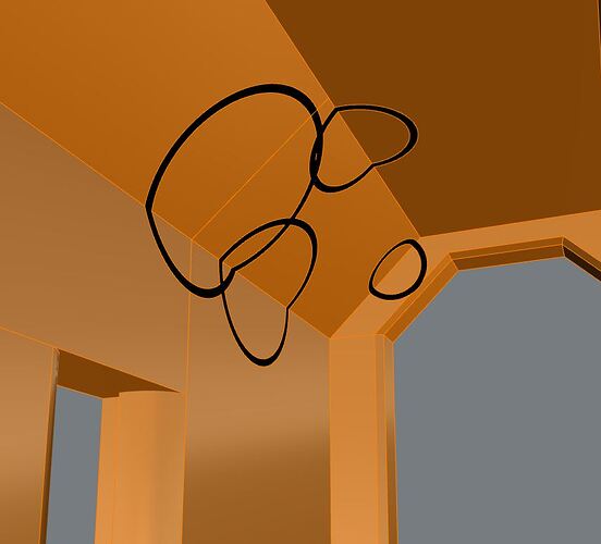

I want to cut a surface with multiple spheres that have a thickness.
What i want to achieve is this effect (like a painted line on the wall)
I tried to populate the geometry (the surface) with spheres with and offset surface.
And the brep cutter… but I don’t know how to manage this messy list..
here is the base surface:
here are the cutting spheres:
and my messy result… I feel that I’m not far away but I don’t know how to get only the circles.
I’m joining the file here, if someone has an idea!

What I’m wondering is how can I get the surfaces between the circles? Because we have now the curves but if I make a boundary surface from curves it’s still a mess…

I suspected you wanted to do more… This version pairs the intersections. Maybe helps?
spheres_2025Apr25b.gh (26.0 KB)
this isolates surfaces… a bit weird to sample geometries with one random point to evaluate Brep inclusion, but does the job :slight_smile:
spheres_inno.gh (20.4 KB)
Yes it is, but apparently works and the code looks simple. :+1:
I thought I was getting there with this approach but am not so sure now. :slightly_smiling_face:

Thanks for the pairs for intersections, but I don’t understand why you use “shift paths” as it works without
the above was indeed not my first attempt (or second… or third… :smiley: )
after Multiple Brep Intersection any geometrical reference is just gone, and in that flat list of fragmens, each of those could lie inside multiple pairs of offseted spheres… I had no idea how to move forward if not trying to rebuild a relation between each fragment and all the spheres used for cutting them, and Point Brep was helpful
before that I also had a thought of using Point in BrepS, but that was again not giving the partial relations but just one single containment value :frowning:
Without “shift paths” you don’t get pairs.
(updated image)
Thanks a lot! It works like a charm
I spend a few minutes to understand your code, and point in brep combine with XOR gate is super clever (I know have to learn more and understand what is mass addition - I will watch more tutos…)
A huge thanks to both of you @inno & @Joseph_Oster for spending time on this.
