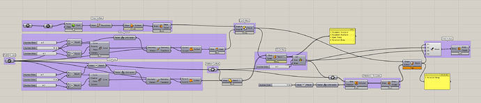

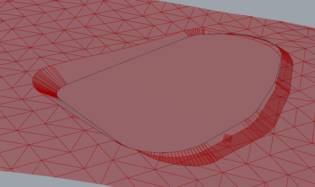

I want to optimize de height of a base surface so that cut and fill would be equal. I want to do that with galapagos in the end. i followed this tutorial https://www.youtube.com/watch?v=mmbIQvS2ZZk&t=1291s which is basically exactly what i need to be able to integrate galapagos.
Problem is with the fill surface. i’m not able to make the split Brep function, i just get invalid brep out of it.. I tried everything i know of but am stuck right now.. can someone point me into the right direction?

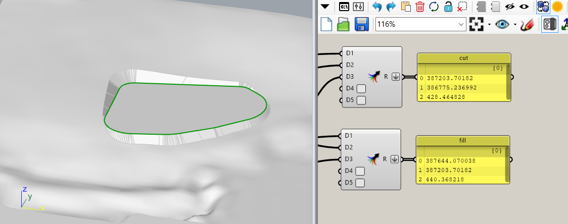

Hey Jakob
Thanks so much for that quick solution!! Really appreciate it, works exactly how i wanted it to!
Now i need to dig into how you did that.. :smiley:

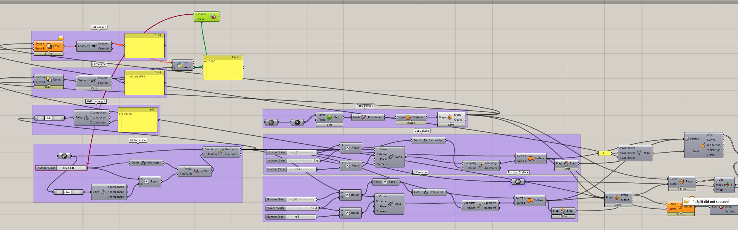

Sorry just one little thing i’ve noticed..
why could it be that if i move the platform line the split sometimes does not succeed? I’ts just on some random heights that it doesnt work
platformTrim.gh (38.2 KB)

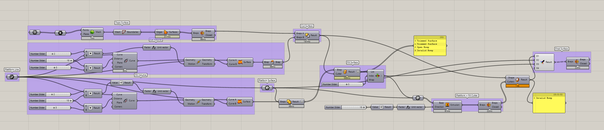

A solution that is perhaps a little too complicated.
platformTrim a.gh (41.9 KB)
