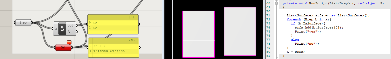

I thought I understood. But here you see I passed two Breps into the C# and a surface holder. The Brep on the left has two surfaces (tell by the thin white line, the interior edge), one on the right single surface. C# says neither of them passes .IsSurface but the surface holder clearly says one of them is a Surface.
Gotta be something I’m looking straight at but not noticing…
and this… I know C# is kinda compiled while Python is all interpreted but I think Python has won this battle
Hi @Will_Wang,
Brep.IsSurface returns true if the Brep has a single face and that face is geometrically the same as the underlying surface (i.e. untrimmed). I can see from your panel that you have a trimmed surface. Thus Brep.IsSurface will return false in this case.
– Dale
Ah! The trimmed surface is always the trouble maker. Makes sense. Thanks!
I guess this outta do it.
