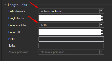

"curvelength" doesn't respect units format
R6
R7
Can you please export that dimension to it’s own 3dm file and post it?
Thanks
curvelength.3dm (23.3 KB)
Very odd.
I’m not getting the same units as you.
I tried making my own annotation text and used a Leader both using your named dimension style.
I am getting fractions, but not the same unit system.
Is curvelength case sensitive now? all lower case still works, just not properly.
Seems to be the case. As well as the rest of Fx’s.
It’s complicated. Fields are for the most part case sensitive in V7, but for compatibility the ones that were in v6 are not, except that there was a bug getting the correct dimstyle settings for the curvelength, area and volume fields. That’s being fixed right now for 7.0
https://mcneel.myjetbrains.com/youtrack/issue/RH-61130
