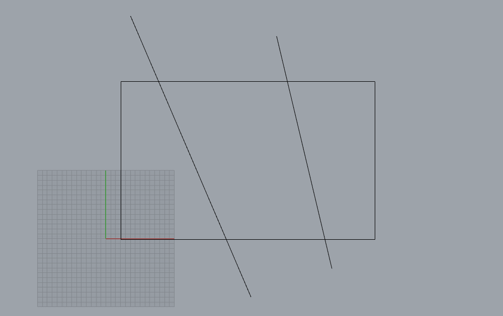

CurveBoolean bug when toggling CombineRegions option
Steps for recreating the bug:
Draw any shape with some overlapping lines like this:
Select all objects and start the CurveBoolean command
Start clicking in separate regions indicating which regions to keep (note: I have CombineRegions set to “No” here)
Now let’s say I notice only after clicking in those areas that I have CombineRegions set to no but I want it to be set to yes and combine the shapes I just marked. So I toggle the option in the command line so it’s set to yes.
Now I press enter assuming it will combine the things I marked before, but it doesn’t:
I would think the command remembers where I clicked before and combines the regions together if I set the command to that, but it doesn’t. What I would have to do is in fact deselect the regions I clicked in before and click inside them again, which makes no sense. It also works the other way around.
