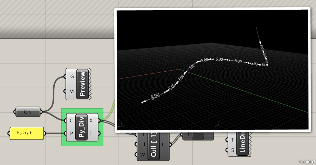

Hi Rajaa
I came across your divide curve by chord length in Gh thank you for providing that nice tool.
One option I don’t know if it’s doable is to have two chord lengths or more to divide a curve. Say one length of 8 followed by a chord length of 5 and then again another 8L 5L division for the entire curve.
Currently I haven’t tried it, can I do one pass of 13 then another or 8 and get my 8 and 5 chord length spacing on the curve?
Thanks again for this tool I was doing it manually in rhino before I saw it in GH.
RM
forum-patterndiv.gh (9.8 KB)
something like this?
Hi Will,
Thank you that’s exactly what I was looking for, nice work!
RM
