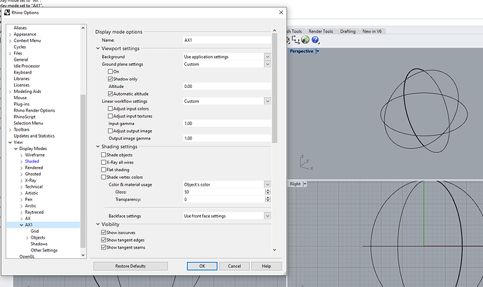

this does create the mode in the menu, but i cannot see how to setup the diplaymode properties as per the manual method to set all objects in this display mode to use one colour etc. I have to set it up seperately in the sactual viewport settings and its not “sticky” in the display mode created. changing object colour settings etc in the code has no impact in rhino, it remains wireframe despite setting shading etc. see the edit view of the mode created like this, none of the settings are actually applied in it?

            DisplayModeDescription.AddDisplayMode("AX1");
            var CreatedAxMode = DisplayModeDescription.FindByName("AX1");
            CreatedAxMode.DisplayAttributes.AmbientLightingColor = System.Drawing.Color.White;
            CreatedAxMode.DisplayAttributes.CastShadows = false;
            CreatedAxMode.DisplayAttributes.ShowPoints = false;
            CreatedAxMode.DisplayAttributes.ShowIsoCurves = false;
            CreatedAxMode.DisplayAttributes.ShowText = false;
            CreatedAxMode.DisplayAttributes.ShadingEnabled = true;
            CreatedAxMode.DisplayAttributes.SetFill(System.Drawing.Color.White);
            CreatedAxMode.DisplayAttributes.ObjectColor = System.Drawing.Color.Aquamarine;
            CreatedAxMode.DisplayAttributes.ShowCurves = false;
            //etc etc.. does not sem to be working though, in rhino view looks the same as wireframe..
            //also cannot fogure out how to set object colour for this mode.
            //now set the viewport as we cannot do it in the displaymode settings above
            SetupViewPort(CreatedAxMode);

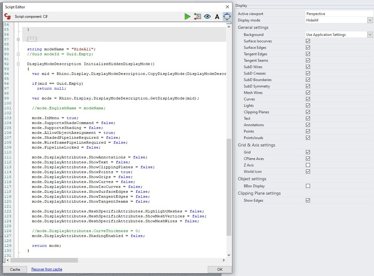

I went all the way but it still has no effect. @dale please grab zip display_mode_mptr.zip (80.8 KB)
open 3dm and load GH there is C# component with code inside. No errors, I’ve prepared ptr on the native side and created instance using internal ctor. However, I can’t see mode in vp dropdown list nor in SetDisplayMode command nor in Options > Display Modes also per object assignment it doesn’t work.
Ah and I confirm that when trying to do it via name and change properties nothing is happening like @ChristopherBotha mentioned
Also copy doesn’t change a thing - It looks like those properties are doing nothing …
