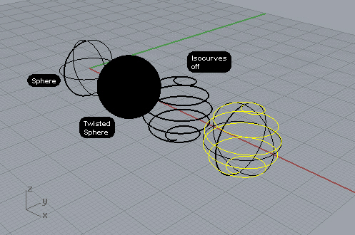

Try this:
Draw a sphere.
Use the Twist command with the axis on the ends of the seam.
Set the Infinite option to Yes.
Twist the sphere as many revolutions as you need.
Turn off the deformed sphere’s isocurves.
Duplicate the twisted seam to harvest the spiral curve.
Perhaps replace the twisted sphere with an untwisted one.
I use 5 revolutions
Pretty clever, John. Never would have occurred to me to use the seam and twist command this way.
Sounds like a good candidate for the Rhino “Tips and Tricks” Wiki page. Or discourse topic.

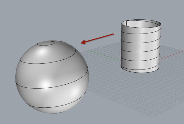

another way–
draw a tube with a helix around it then FlowAlongSrf using the tube as base surface and a sphere as the target surface…

The problem with those solutions is - The pitch of the ramp will increase as the distance of each revolution becomes shorter near top of the dome. You could simply make an array of lines, then use ApplyCrv (or flowAlongSrf) to get them onto the sphere. This may not maintain an exact pitch on the ramp, but it will reduce the height of each revolution in a consistent manner…
(actually just read Jeff_Hammond’s method which is essentially the same thing)

Thanks a lot jeff, your method was the one that best suited my needs, I had forgotten about my old friend FlowAlongSrf!
