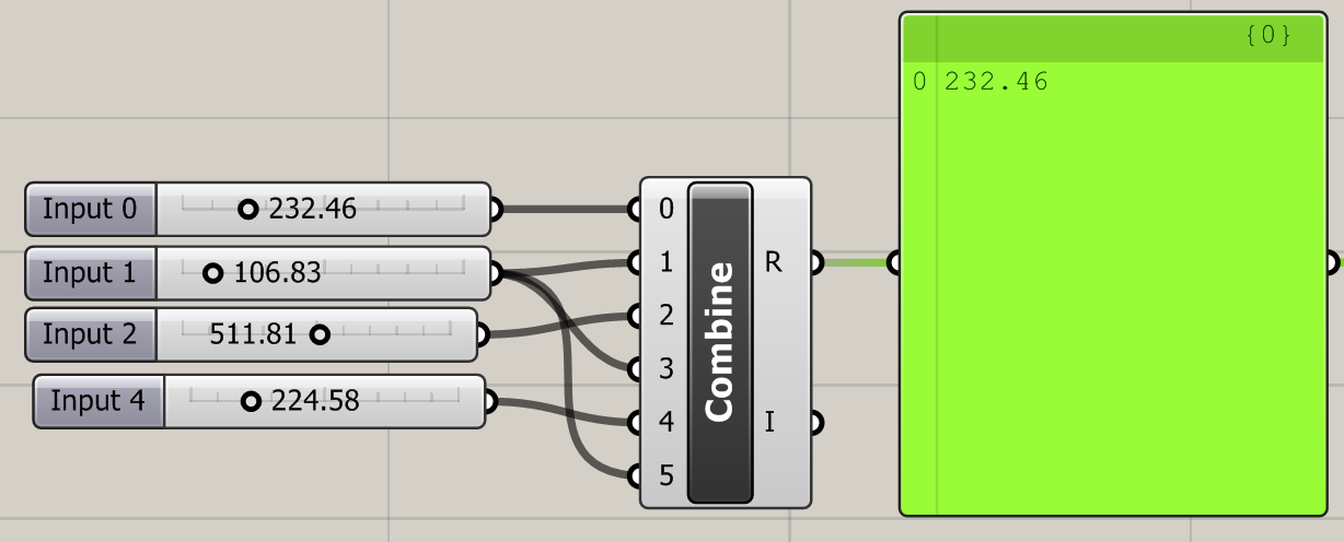

Creating a list of numbers using various sliders
i want to create a list of numbers using some sliders. as i use one of the sliders several times for different positions in the list and also want to keep track on which number is in which position, i was looking for a component with multiple inputs. i tried “combine data”, but it only ouputs the first number.
ans suggestions which component to use?
am i using “combine data” in a wrong way and what is supposed to do?
I guess you’re looking for Merge component, as an alternative you can also use GenePool.
merge looks perfect, thanks!!
forgot about gene pool.
anyhow its not as nice as merge, as it cant use one slider in various list positions …
