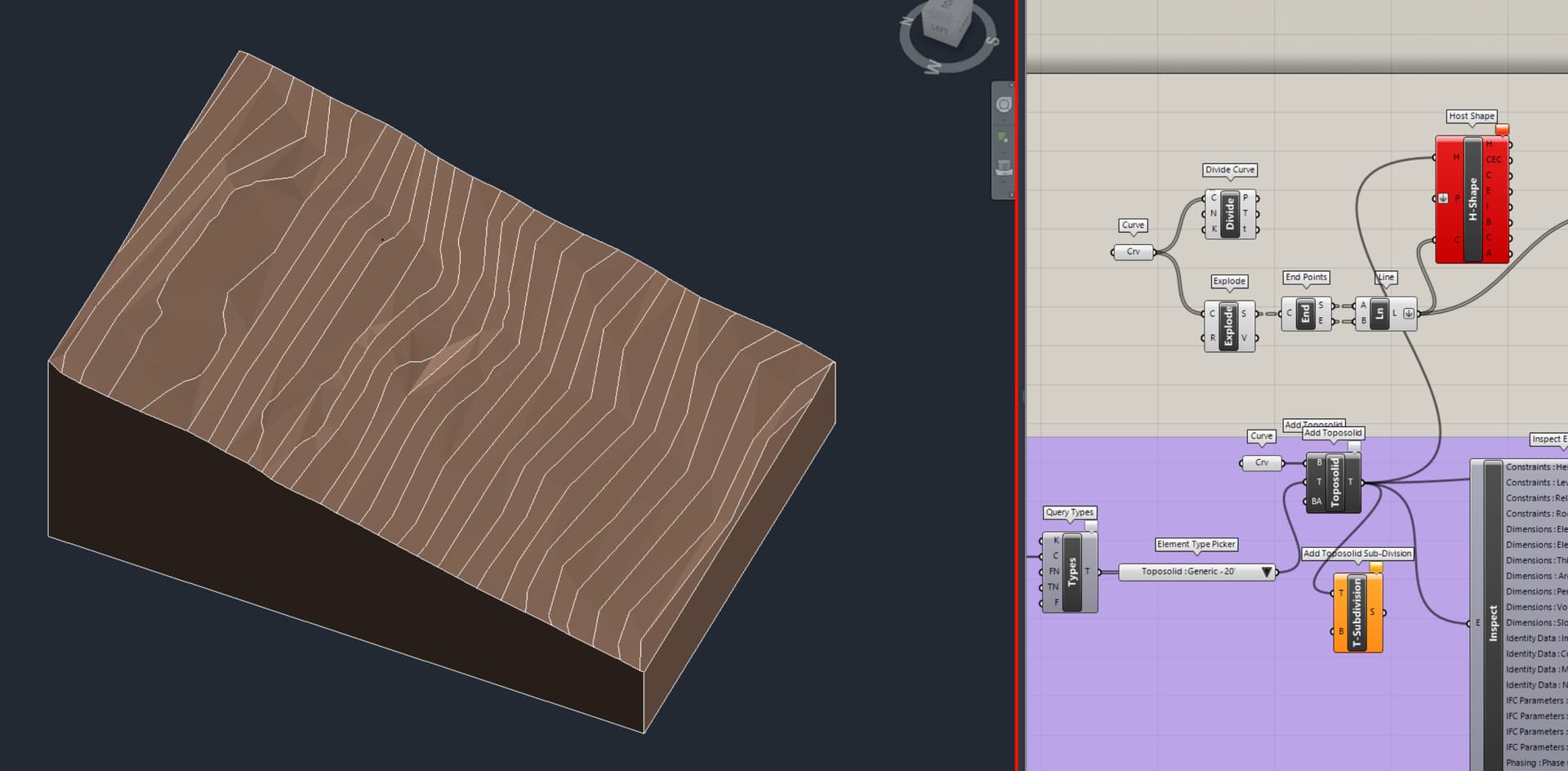

The toposolid is working, but I am having trouble controlling the insertion elevation of the toposolid. I mean that the toposolid is coming in associated with project Level, whereas it should be associated with the Project Base Point or Survey Point (absolute elevation about sea level).
Rhino: you can see proper elevation of topo
 ![image](https://global.discourse-cdn.com/mcneel/uploads/default/original/4X/d/2/5/d251b93e2da102a39c33f9b14d7f86d075fcf5f5.png)
Revit: you can see toposolid comes in in relation to Level 1, rather than in relation to Project Base Point, which is my 0,0,0 in Rhino. The contours you see in the proper location I sent through as a family with insertion point
 ![image](https://global.discourse-cdn.com/mcneel/uploads/default/original/4X/1/1/7/117847258c43ed118c4a1c3db56d2671bb1c5e27.jpeg)
In this [Video](https://help.autodesk.com/view/RVT/2024/ENU/?guid=Revit_API_Revit_API_Developers_Guide_Discipline_Specific_Functionality_Site_html) showing a toposolid made from sketch, in the toolbar you can see that the subelements of the toposolid sketch are given an “Elevation Base”, in the video set to Project Base Point.
Screenshot from the video:
 ![image](https://global.discourse-cdn.com/mcneel/uploads/default/original/4X/8/9/9/899e766a957174b3a2520cfdfab789406eb255bc.jpeg)
It seems that the Rhino.Inside.Revit add Toposolid component is setting these by default to Level 1?
Here is the [Revit API page](https://help.autodesk.com/view/RVT/2024/ENU/?guid=Revit_API_Revit_API_Developers_Guide_Discipline_Specific_Functionality_Site_html) I found:
My current solution is to use the Height Offset from Level parameter of the toposolid to move it down to where it belongs, but this feels very prone to inaccuracy. I’m not even sure what the origin point of the toposolid is, which is determining the relation to the level. Is it the bottom line/point in the contours? It definitely is not the bottom of the solid itself, as the solid thickness can be modified. It must be somewhere on the top surface.
 ![image](https://global.discourse-cdn.com/mcneel/uploads/default/original/4X/d/e/9/de9c9fe707a5fa9bcbd9e1a66bf50772404754bf.jpeg)
Anyone understand how I should be doing this?
@Japhy @kike
<div class="post-metadata">
**Author:** ![Japhy](https://sea3.discourse-cdn.com/mcneel/user_avatar/discourse.mcneel.com/japhy/32/487647_2.png) [@Japhy](https://discourse.mcneel.com/u/Japhy)\
**Post date:** [December 18, 2023, 7:31pm UTC](https://discourse.mcneel.com/t/create-toposolid/161260/16 "2023-12-18T19:31:28Z")
</div>
Hi Brian,
The Boundary, where you can control the Base Insertion, has its lowest point determined by the TopoSurface Type.
 ![image](https://global.discourse-cdn.com/mcneel/uploads/default/original/4X/5/c/b/5cbd53795a6e6ef7992c9606c9ee4a22f9dbb89e.png)
The modify Sub-Elements Elevation Base does not appear to be available via Revit API and is a Revit UI feature only. ([SlabShapeEditor class](https://www.revitapidocs.com/2024/573209b9-3d5e-6175-95e2-e48bb88f02ca.htm))
