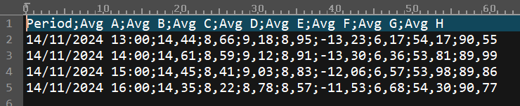

Now, I tried to write everything back to an Excel or csv sheet. Unfortunately I dont get how to organize the list so that it can be written. At the moment, it doesnt work yet.
I think its a really simple problem, but I am a complete beginner in this part of grasshopper - sorry about that!
hourly mean TN_MH.gh (17.5 KB)
I’ve bolted this on to my existing definition. I might have made some different decisions if I’d known we were aiming for CSV output so there’d be less data mangling, but it works well enough :slight_smile:
(Instead of the TTboolox plugin, I use this old C# script)
hourly mean TN3.gh (20.4 KB)
