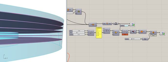

I would like to create 6 floors.
The first floor with 6 meters and the others with 3 meters.
I tried divide external surface and connect curve but unsuccessfully.

Welcome @kleyton.menezes,
Here’s what you can do:
generate-E_v2.gh (14.1 KB)
Hi Kleyton,
You can make horizontal planes at those heights and then use brep/plane to slice at those floors.
generate-E.gh (19.1 KB)
Solution similar to P1r4t3b0y
Use Brep | Plane intersection
Another approach using StackData + Contour.
generate-E_v3.gh (14.7 KB)
Created floors with thickness following the curved facadegenerate-E_ME.gh (16.3 KB) (floors that don’t protrude the facade)
