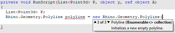

List<Point3d> P;
Rhino.Geometry.Polyline polyline = new Rhino.Geometry.Polyline(P);
