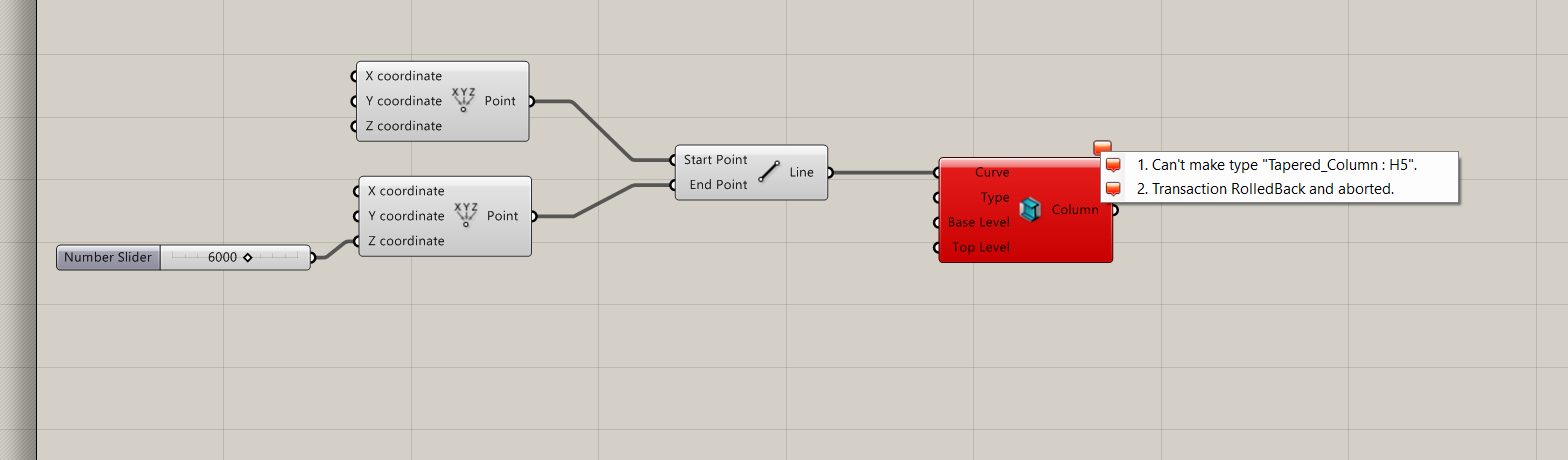

Create column problem
where is the problem for create column by line ?
I’m not able to duplicate. Can you provide some more information? Is this the first time running the script? SystemInfo?
yes this is first time run script
Can you right click on Type and make sure there are Column Families available? Probably the same with the levels as well, even though you haven’t specified it should have those available in the document.
it’s work for standered family but with tapered coulmn dosen’t work
thank you sir i figure problem with my type of family
