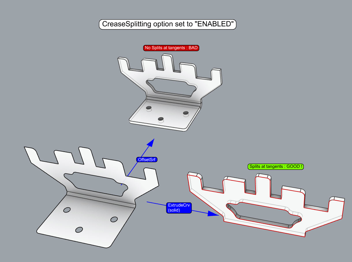

Just as it says in the title : this is a pain in the nuts when drawing bent steel plates in particular.
I need those splits, so since I toggled the “CreaseSplitting” to “Enabled”, I want those splits at tangents no matter if the solids are created by extrusion or by surface offsets.
260414_MOD_Split At Tangents fail.3dm (668.0 KB)
I know I can use DivideAlongCreases (tangents=yes) to fix the problem.
I’m not after workarounds, I’d just like McNeel to fix this inconsistency.
