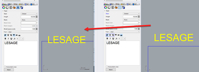

I do have the same problem regarding messed up layout position of text when copying and pasting into another Rhino file (the original file was developed while Grasshopper was in use paired to that original file).

Hello Pascal,
problem can be seen from uploaded screenshots.
In first pic you can see text with correct native layout.
This is the content that has been copied in the “native Rhino6 file” which contains only this content (no previous Grasshopper work).
This content has been than pasted in a “new Rhino6 file” in which I have been working previously with Grasshopper.
In second picture you can see text has changed position, translated (lines instead maintain correct position).

In the first image it looks like the text is justified upper left, and in the second, lower left. My feeling is the justification did not transfer correctly for some or all of the text. If you turn on control points for all the text in both cases, do they look like they are at the same locations? Has the location of the text in relation to the control points changed?

  • Helvetosaur: you are right, text justification has changed from upper alignment to bottom

Now that the cause of the problem has been pointed out I am still searching how to prevent justification changing.
