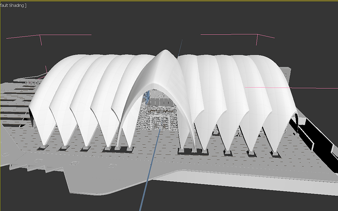

So I was given this free form shell that was created in 3ds max and I want to replicate it in rhino to a simple surface with the least amount of divisions possible so I can start using it in grasshopper to divide into panels and work on the structure.

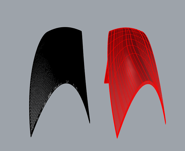

But no matter what I do, the output created in rhino is not a 100% match. I have tried extracting the mesh edges and then rebuilding them to reduce the control points and the sweep2 which gave a very close outout but not 100%.
the white lines are the original mesh while the orange is a make2D from the rhino model I created.
I have also used MeshToNurb but it created a very heavy surface which I could not reduce later.
the red surface is the result from the sweep but it’s not a perfect match

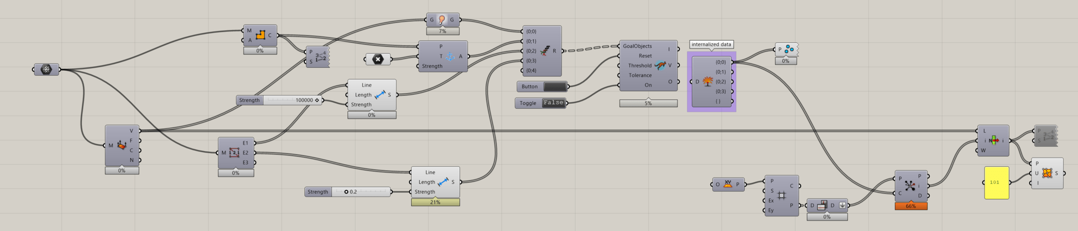

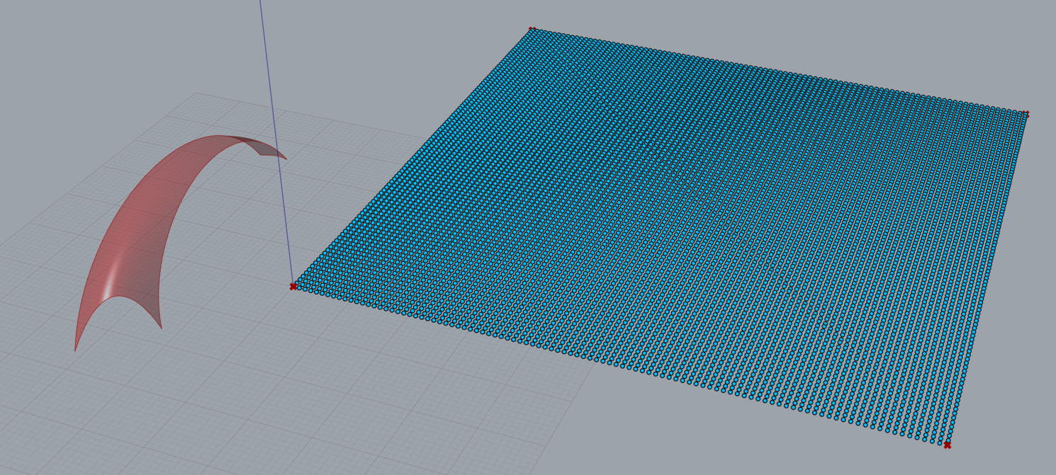

The mesh has a nice grid of 101 x 101 points, however the vertices are disorganized.

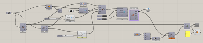

To start somewhere, I took just the outside of your mesh and eliminated the underside and rand. I transformed the mesh vertices to a horizontal square grid to be able to sort the vertices. There are probably other, quicker solutions?
20_05_21_surface_from_points.gh (1.3 MB)

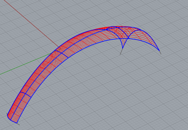

Hello - if you need a surface, then taking some sections and edges of the mesh parts is where I’d start - these can be input to a NetworkSrf for example -
I have tried this solution by extracting the edge curves of the mesh along with multiple perpendicular sections but somehow the result wasn’t identical.
this is brilliant thank you! but I’m not sure I fully understand what you have done. because I have to replicate it a bunch of other time to make the other shapes of the shell. so if you could explain what you have done I’d be very grateful. thank you so much for your time.
that was my try with the cross sections and even though all of these curves are extracted from the original mesh the output was not identical.
Thanks! Rebuilding the surfaces with cross sections is nonsense. You do have good meshes but somehow messed up topology. All I did is stretch the meshes to a fully orthogonal mesh in the XY plane so I could recreate a point order. The point order is required to rebuild the surface.
Brilliant solution man thank you!!!
