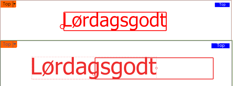

The text string might be the same but the text object is not. A copy - paste from RH5 into RH6 converts it into rich text and gets the style of the current style assigned to it.
Copy-Paste of RH5 [top] text and bounding box rectangle into RH6 [bottom]:
So…
… that doesn’t surprise me.
