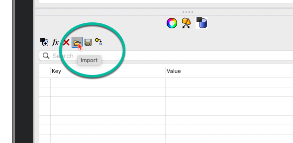

At this point, normally I open the VBA copied and renamed TOC template file, select and delete all the place holder Doc User Text items, and go to the TOC index layouts and delete those layout user text items.
Next I import the document user text items from the pre-written CSV file and the table of contents layout user text files from a pair of CSV’s for those and save the TOC File.
Finally I open the various other file types, select and delete the placeholder Doc User Text and layout user text items and import the “new” Doc User Text and Layout User Text values from the just saved job TOC Rhino File and I’m done.
All the revs are in place, the layouts all have the proper page numbers, all that.
However..
For the last couple of months (not sure what update it was) that’s utterly broken.
Everything is fine right up to attempting to open any CSV to load either document user text or layout user text item. Hitting the open button (folder icon on the Doc User Text or Layout User Text panes) generates an instant fatal.
Further, if you’ve got unsaved changes when doing so (which is often the case during revisions) you lose those as well as the ability to go back to the temp file as well.
This bug has to be due to some change somebody made to that portion of the code as it always fails with this:
