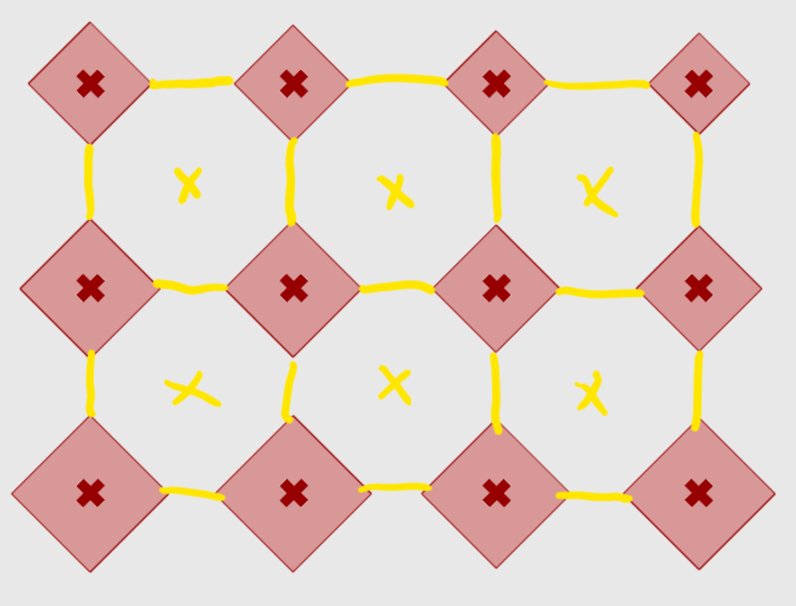

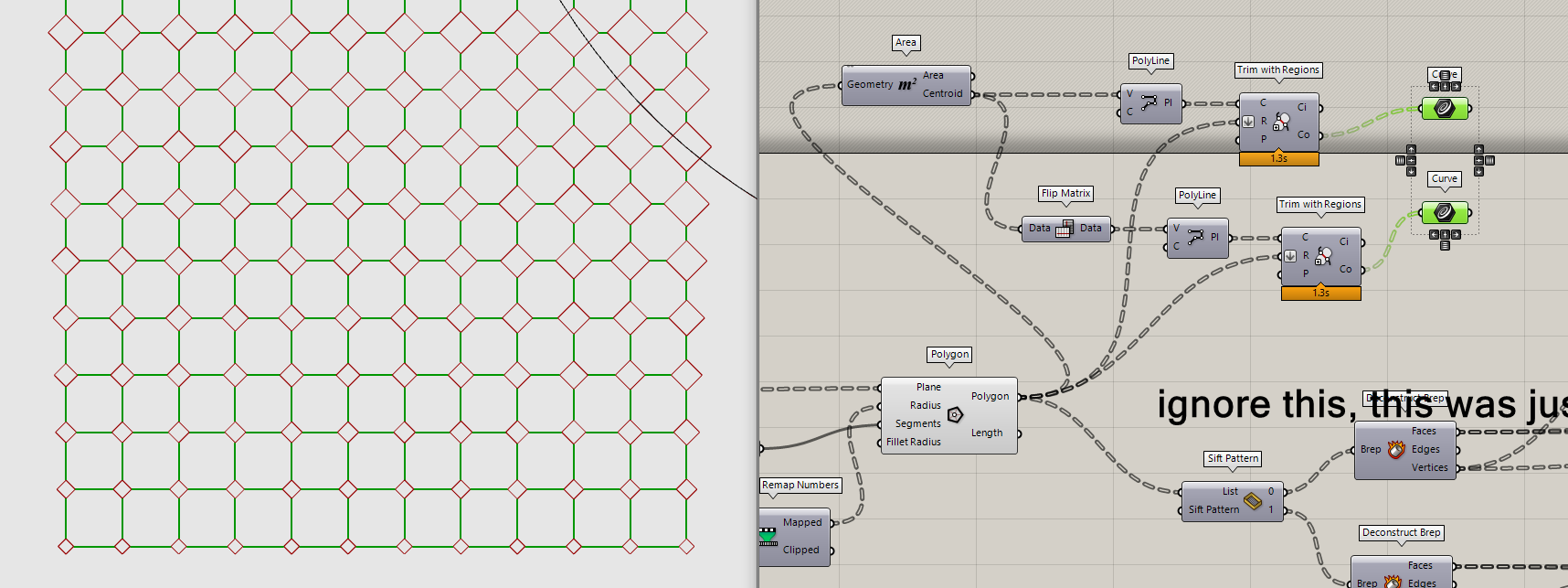

Hey so I’m creating panels along a grid, and I want to connect the corners of each shape to form a new shape, for reference, this is what I had in mind:
attractorexample.gh (43.1 KB)

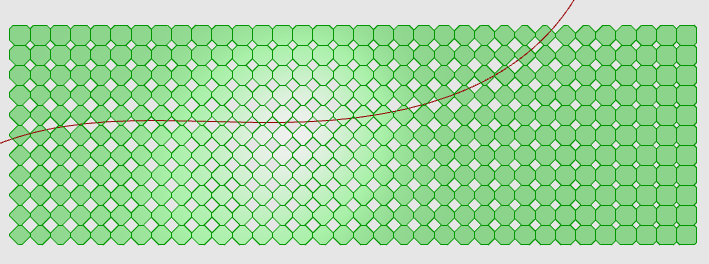

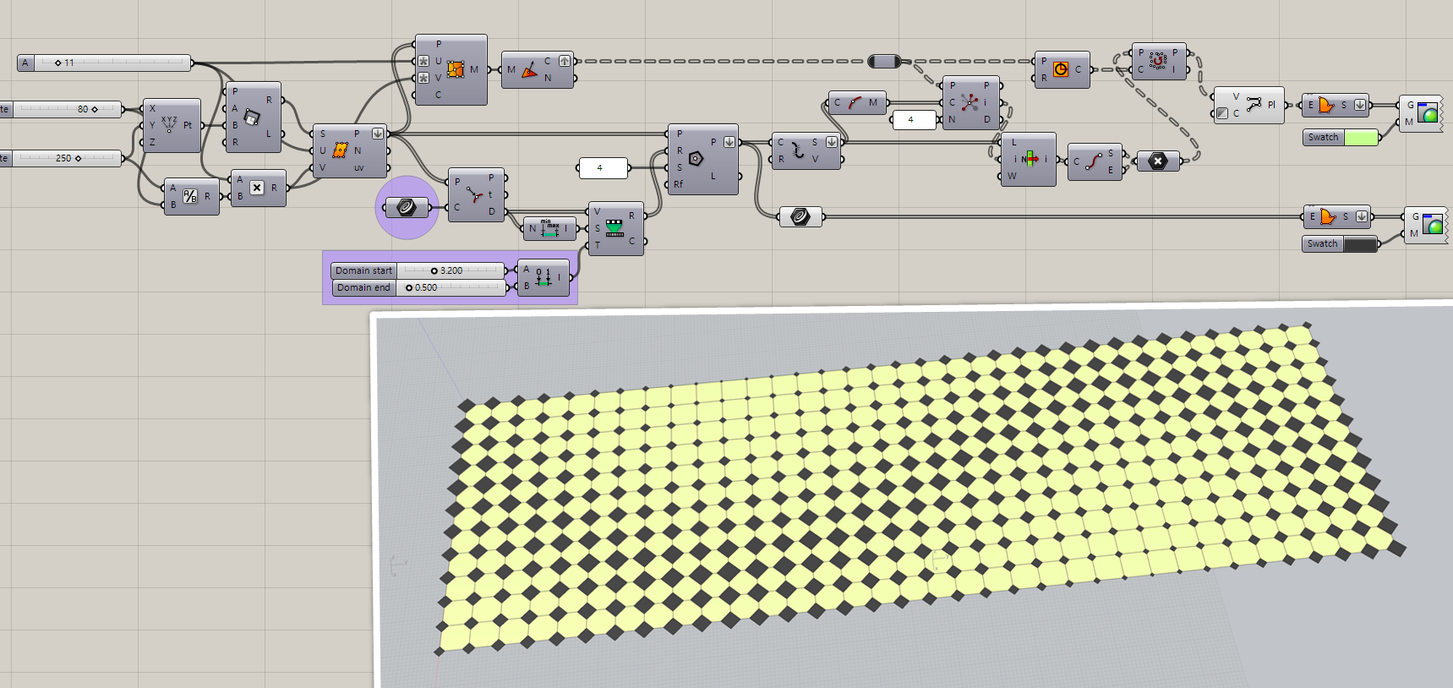

you havent internalized your attractor curve, so i created a new one. Anyway it should work with your att-curve as well.
attractorexample_RE.gh (28.8 KB)

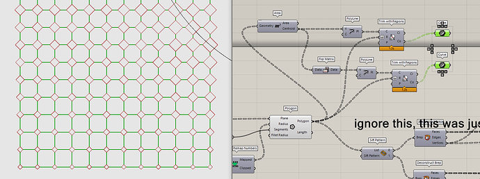

Thanks, though I was hoping these new octagons could be formulated into shapes. I’m also playing around with the actual shapes of the panels, so this certainly helps for the diamonds, though if I were to make the diamonds into a hexagon via the segments of the polygon, this no longer works.

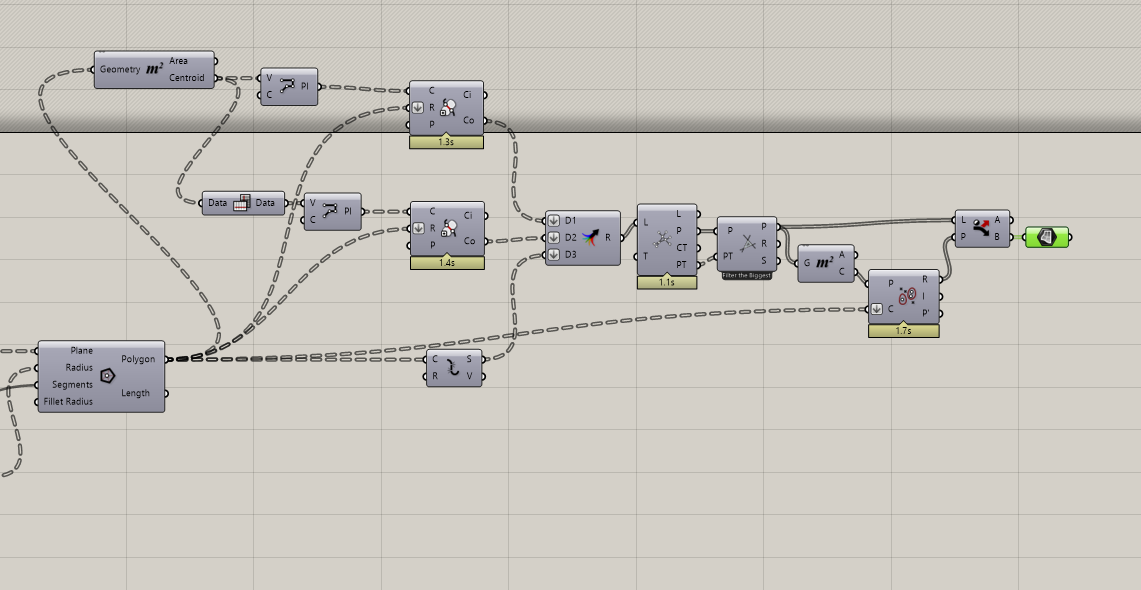

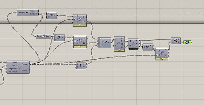

You will need Heteroptera for this, since i intentionally avoided expensive Surface Split method.
attractorexample_RE.gh (18.1 KB)
