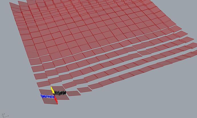

hi
I have a list of surfaces that are floating around. I would like to patch the gap in the zaxis with a surface.
Like i draw in here:
From the top, the corners of the parallelogram are kongruent with the corrosponding corner of the parallelogram next to it.
Does someone have an idea how to do this? I thought about some trimming solution but that doesn’t seem to make sense to me.
here i only have 121 surfaces. later on i will have a lot more surfaces. so it should be efficiant
thanks in advance
Chris
File with surfaces:
connecting floating surfaces.gh (64.2 KB)
It would’ve been great if you included whatever you did to try to solve this, rather than just the surfaces and nothing else, specially because I don’t see why you are thinking about trimming something.
Anyway, if I got it right, maybe this helps?:
connecting floating surfaces.gh (71.5 KB)

sorry. I didn’t even try trimming because i know it is very heavy to calculate (i mean it takes a lot of time)
and my solution that i tried seems a bit stupid ^^
also works but yours seems more elegant to say the least
thanks

connecting floating surfaces_V2.gh (76.5 KB)
Hi
I made a little adjustment to your solution. sometimes the surfaces cross. and have an intersection. this could lead to issues. I know since I just had them ^^ just uploading to preserve incase someone else ever needs this
I see what you mean, I did not expect the cases where neighbouring edges intersect, Good catch!
