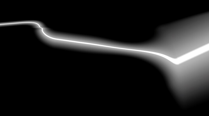

I have a complex surface transition for which I’m unable to find a solution after a lot of trying.
This is what I was able to accomplish and how it should look like in the final shape.
But, as you can see it’s a mess. I tried to build surfaces with the same degree to match each other but in the end, I wasn’t able to have a curvature continuity between all the surfaces, not even a tangency continuity in some cases.

Hello - it seems to me I’d keep these surfaces linear
and match all the others to them. Also make sure you adjust your Zebra (Analysis mesh) mesh to be very fine - 5,000 + in the ‘Minimum grid quads’ setting.

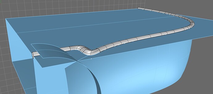

Here’s a possible option. built everyting to theoretical sharps and after this trimmed back. These may not be the exact aesthetic you are going for, but by adjusting the size of the blends you can tweak ti to your liking.
Test_Blend.3dm (2.0 MB)

You can still use the same techique. I used a simply 0.2mm offset to create the outside rounds, but you could use a tapered pipe instead to get the transitions you need. This will allow you to control the width of the opening between the theoretical sharps.
If you can get the model to look good with theoretical sharps the blends will always turn out well. Based on my experience it’s nearly impossible to get good blends if you are simply guessing the openings of the blends. I know these can be quite tricky to model, hope you will find a good solution.
I followed the suggestion from Pascal and rebuilt everything, matching to the linear surfaces. In the end, this was the result. I still have some issues with the matching of some of the surfaces but it’s much better now. It was even difficult to visually spot these problems with zebra because they are visible in a few angles.
I think it looks ok but it can be better.

General rules of thumb for blending/filletting is to start with the biggest radii and work to smaller ones. In this case, from what I can tell is that the vertical blends/fillets are bigger than the final one that runs along the top flat surface.
The way I did this is to build all the vertical blends/fillets first and the smallest on along the top surface last. Does that make sense?
@FFstudio - I would simplify this surface:
The more points, the harder it becomes to keep things under control, especially at high degrees - if you are increasing the degree to get more points, I would be careful of doing that beyond degree 5, rather, InsertKnot > Midpoints =Yes. But I do not think you need that here.
Simpler.3dm (43.0 KB)
