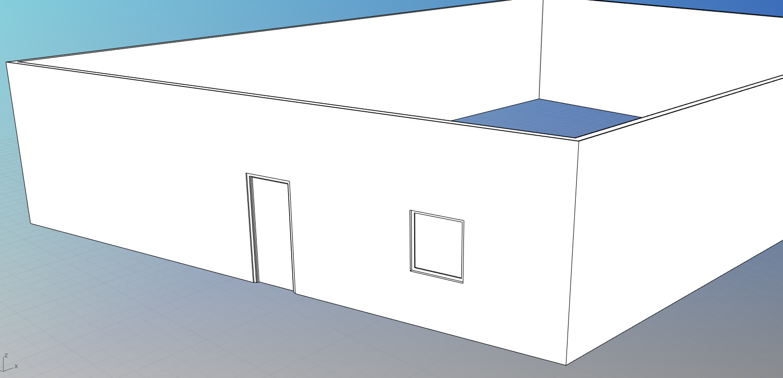

Hi. I updated to the latest Beta 2 version of VA 3. I could not see any texture being applied to any va components like door and windows. All seems white. Earlier all the texture were working nicely in previous version! Is this a bug?
Hi @asisintel,
Are you using a VisualARQ template?
Do you have the material applied in the correspoinding layer and the style layer attributes as “By Parent”?
Hi @alfmelbev . Yes the materials were there. Finally I uninstalled it and restarted the system and again installed VA3. Now its working. Dont know what was the issue. Will let you know if issue arrives again!
