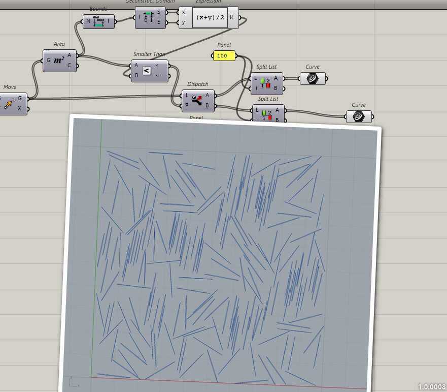

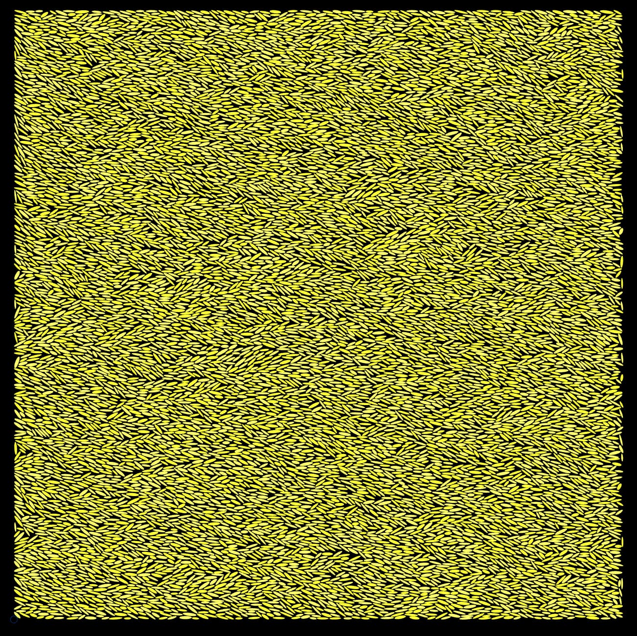

Hello everyone,
I’m working on packing closed curves inside a rectangle. Specifically, I want to pack curves that look like ellipses while controlling their aspect ratios and their distribution within the rectangle. I tried using a Grasshopper script designed for packing circles, but I haven’t been able to prevent the ellipses from intersecting. The picture below illustrates what I’m trying to achieve.
 ![CURVES PACKING](https://global.discourse-cdn.com/mcneel/uploads/default/original/4X/6/e/9/6e9870657a704a676fd4a83ea7962d3b50722a7d.jpeg)
[CURVES PACKING.gh](https://discourse.mcneel.com/uploads/short-url/wJfWAuMNnIT2Csya1krsaHI04GX.gh) (33.8 KB)

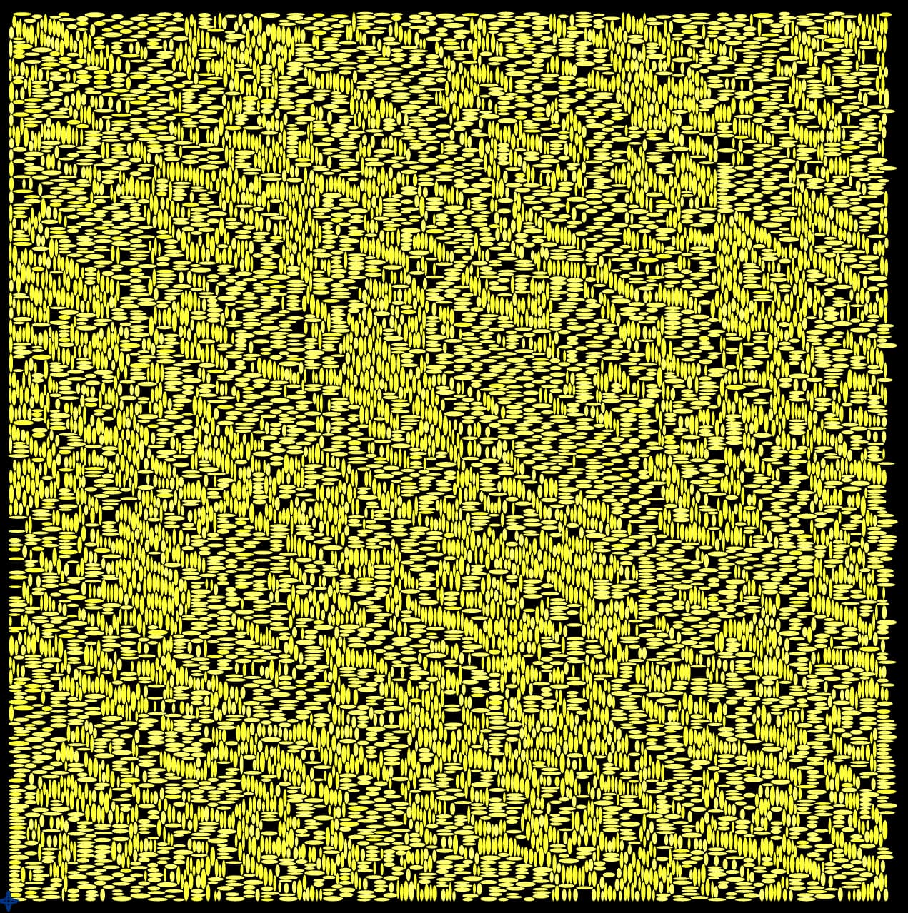

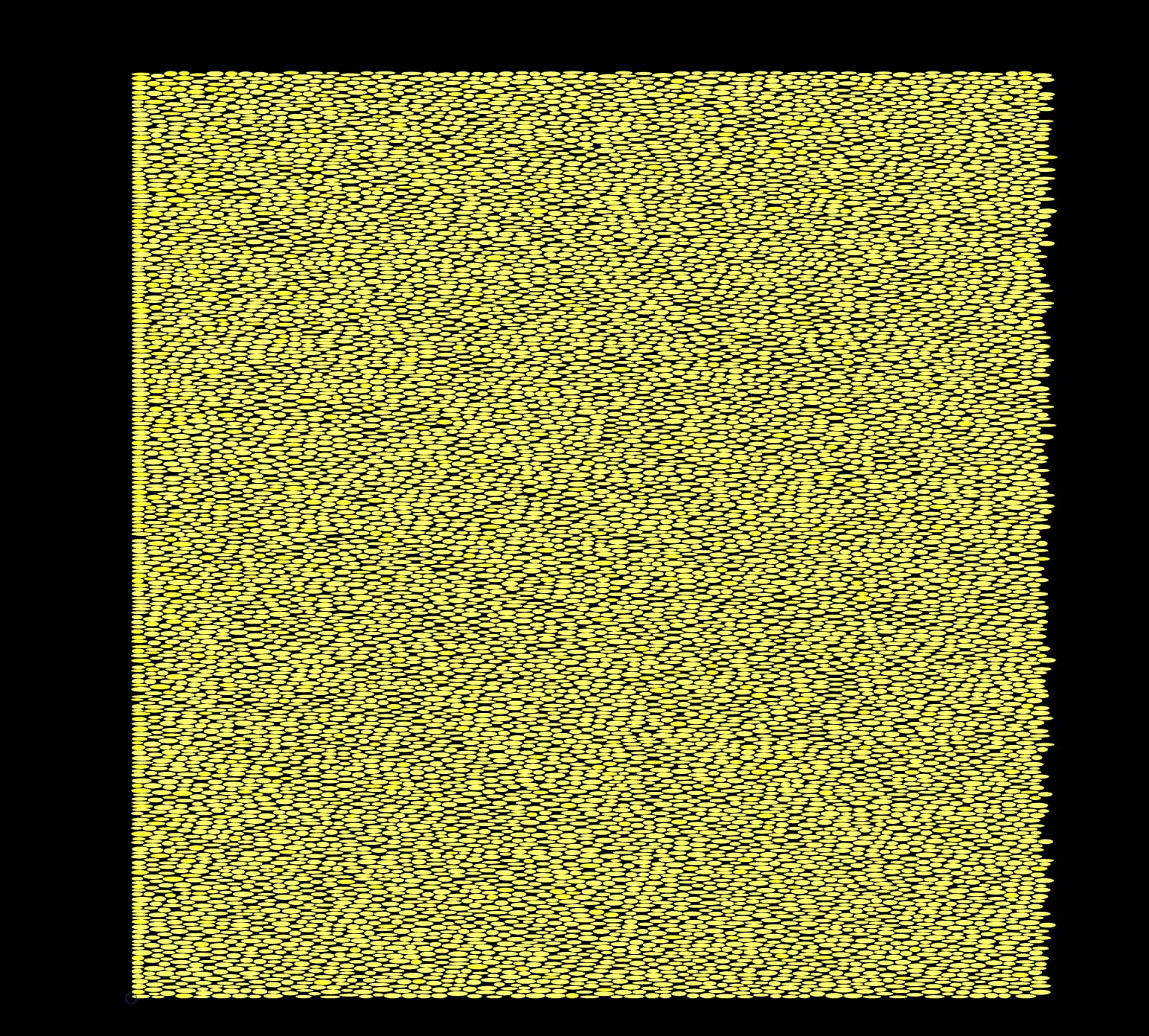

Hello
for what is worth my tool is not so bad, but is not nesting as objects cloud be duplicated and/or all objects are not used.
 ![image](https://global.discourse-cdn.com/mcneel/uploads/default/original/4X/e/4/5/e452d90b98b83e69f44518aa63d9debafda61a4c.jpeg)
No rotation
 ![image](https://global.discourse-cdn.com/mcneel/uploads/default/original/4X/7/7/1/771a2c54edffc1a67be9a80b8324cba3cdbbfe49.jpeg)
[ellipsoid\_pack-MODIF\_LD.gh](https://discourse.mcneel.com/uploads/short-url/msYDvvD2wMmH84gXVtcCARQWcnn.gh) (13.3 KB)

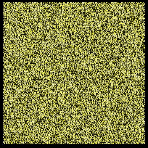

Some others tests (resolution 1600 pixels, ~50 s calculation)
RandomPlace = false
Random object = true
 ![image](https://global.discourse-cdn.com/mcneel/uploads/default/original/4X/8/d/b/8db6a3515e2175f4a0edf68dc3fc20b33a51689c.jpeg)
 ![image](https://global.discourse-cdn.com/mcneel/uploads/default/original/4X/8/0/f/80fc98b26eb84824773c7edf6929dd1d44ed3f07.png)

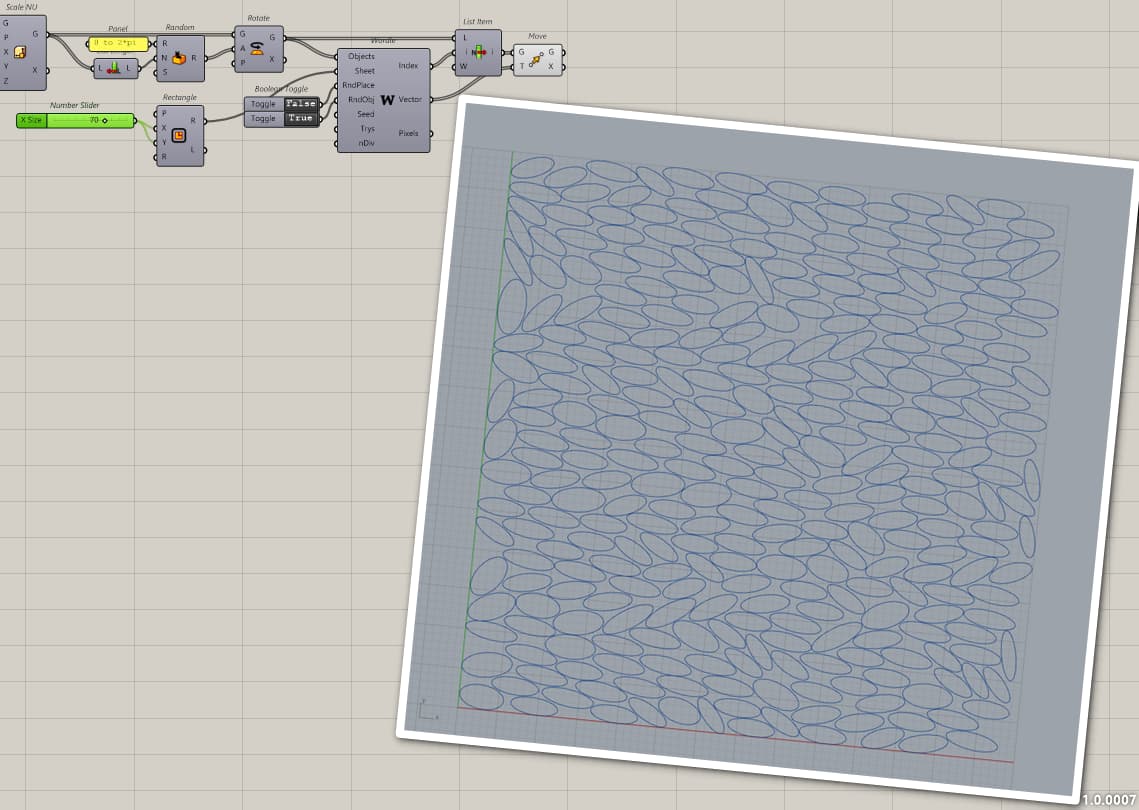

RandomPlace = true
 ![image](https://global.discourse-cdn.com/mcneel/uploads/default/original/4X/5/a/a/5aa1b031db9edcaea1abc36625aead8edbe89f7f.jpeg)
No rotation
RandomPlace = false
Random object = false
 ![image](https://global.discourse-cdn.com/mcneel/uploads/default/original/4X/1/c/8/1c811ad4fbbf3251728b0659603c38a8b35cba2a.jpeg)

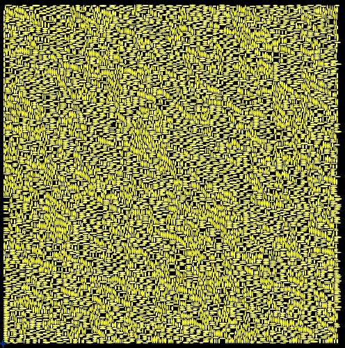

generating 50 random ellipses and turning them by 90°
RandomPlace = false
 ![image](https://global.discourse-cdn.com/mcneel/uploads/default/original/4X/3/b/c/3bc60aba20d53c38104f1537ddc3956ad7c50a2e.jpeg)
 ![image](https://global.discourse-cdn.com/mcneel/uploads/default/original/4X/f/d/b/fdb23bbe440a4d8c8e1f32bd8a35a7812548a9e4.png)

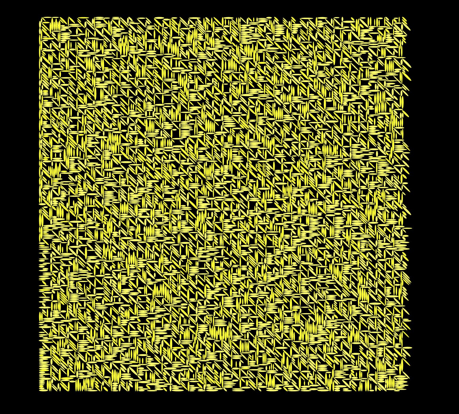

generating 50 random ellipses and turning them by 90° and 45°
RandomPlace = false
 ![image](https://global.discourse-cdn.com/mcneel/uploads/default/original/4X/6/2/1/621ec6b5d388809f8c935a3db35ca3f7545b4630.jpeg)
[ellipsoid\_pack-MODIF\_LD\_0\_45\_90deg.gh](https://discourse.mcneel.com/uploads/short-url/zQJq1pxbAA9ddjUcp4Dx3mYJduD.gh) (14.7 KB)

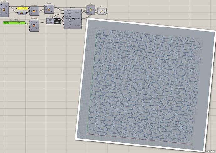

Hello
this is not possible with my tool but as my tool outputs more ellipses you could suppress some of them.
 ![image](https://global.discourse-cdn.com/mcneel/uploads/default/original/4X/3/d/c/3dc976bc403763f164823ba35e381f2e53460fa6.jpeg)
[MODIFIE.gh](https://discourse.mcneel.com/uploads/short-url/g6I3ijFL86imkWA3S9SSDjOGhfo.gh) (14.9 KB)
