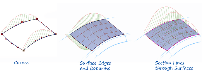

Alias does this well. The first and second CV tell you what you need to know. Also for surfaces.

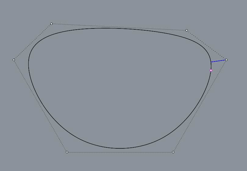

closed Curve, Degree 3, 6 cv’s
pink = End/Start Point
blue line shortest Distance from “first” CV (perpendicular) to Curve.
how would that apply to above curve ?
do i miss something ? can i learn something ?

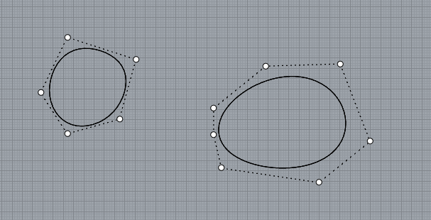

In general closed NURBS curves in Rhino do not have a control point on the curve at the ends/seam of the curve. Very simple examples:

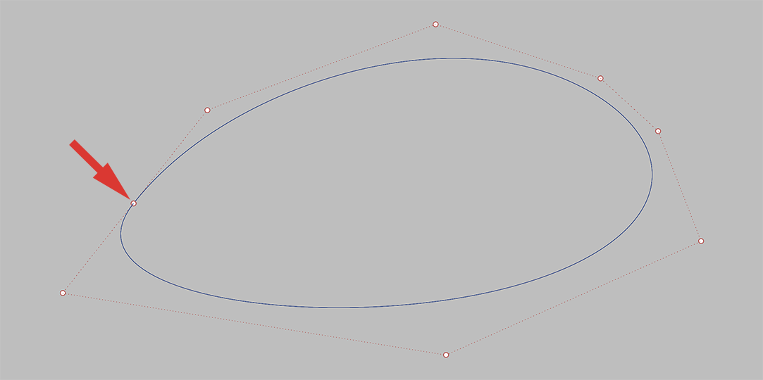

Very odd. Here, in Rhino 8 macOS, I have the first/last CV on the closed curve (degree 5/4 spans), where I would expect it to be.
