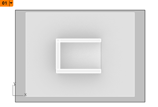

My detail viewports showing plans and sections generated with clipping planes and set to arctic does show a dark shading through sections, but when I print the pdf using rhino pdf, the hatching/shading is missing. Guys, I canât have this! Im under pressure to get these drawings out properly. Please let me know how to fix this asap. Thank you.
Anyone? Im trying all the different views (shaded, rendered, etc) and none are printing the hatching in the clipping plane. What do I need to do please?

Weâll probably need a sample file to try and repeat the issue. Mentioning @DavidEranen and @jeff in case they have seen this before
@PeterB please send us a file which shows the problem. This will be the fastest way for us to potentially fix the issue.
Also, could you copy the text from Help -> System Information...
Thanks,
-David
Here it is (attached) clipping plane not shading.3dm (1.5 MB)

Hi @PeterB,
In the Print...
dialog, go to View and Output Scale
and select Extents
instead of Layout
. You should get what you see in the viewport.
I donât exactly know why the original Layout
doesnât work. Any ideas @stevebaer?
Doesnât make a difference for me by printing to extents instead of layout. Just tested both on the same drawing, and got the same results in both case. Still no shading printing.

Hi Peter,
Just to make sure that we get all the information hereâŚ
On my system, this is what I see with factory-default Artic
Rhino Top viewport:
Layout view:
PDF output:
I guess that is not what you are seeing on your end. Could you share some pictures?
Also, does it work as you want when you print the model space Top view to PDF?
No, thatâs not what I see. My preview shows the wall hatched in the case of a clipping plane. This entire matter is regarding clipping plane not hatching when I print. So while I do see it hatched on my window in rhino, when I print PDF, regardless of which of the three pdf printers I use, it comes out without the hatching.
Again, could you share some pictures? There is no hatch in your document, so I donât understand why this should be showing anywhere. I read that you used all possible display modes, are they modified from factory-default in any way?
As for this one:
If you select Maintain source layers
in Make2D
, the 2D output will be separated on layers as was the case with the input geometry.
