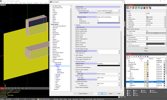

Thanks guys. Maybe it only works with materials? though the interface in many different places offers the choice of colours?
For drafting, we use Wireframe View Mode. Materials don’t show up. We need solid fills. The interface offers that in several different places, but it seems to be unreliable.
Really appreciating the effort at the videos though. Gives me hope that maybe we can solve this. The Rhino tech support seems stymied and recommend the Section Tools plug in, but it comes with a great many caveats and limitations.

It’s actually transparency on the backface that cancels fills out.

The problem is that they rely on view modes which render surfaces opaque, so occlusion issues are likely.
You can change the visual mode of a single object you know, it can be displayed as shaded in a wireframe mode
Unfortunately it then becomes opaque and occlusive. Sometimes that would be okay, sometimes not.

Well, that’s certainly getting there, and I know how to tell Rhino to do that, but its compliance is always a crapshoot. Where (of the many places to set that) did you do it?
Wot? How?
Technical view mode?
No, it’s not that.
hatch.3dm (82.1 KB) shaded-wireframe.ini (12.5 KB)
if you want to see through the hatch, then add it to the transparency slot instead. (and reverse the colors)
