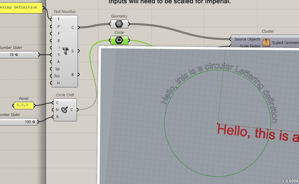

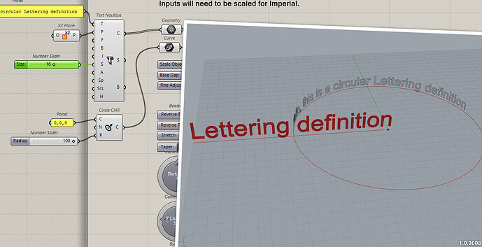

@T_Reischl nice definition, replace curve by circle it will be more clear for everyone.
Funny when scale is to big
Yes, we understand that. I was just wondering about where the letter geometry was supposed to come from; like why there wasn’t a Text On Surface component or similiar, so I asked for internalized geometry, and the OP got wierdly defensive.

As to your technical question “text on surface”? there is no need for a “text on surface”, in fact, it will work with all sorts of geometry that is not lettering. It does not need a surface to function.

Yup, the scale can cause that, so can a way too long text/object string. It just runs off on a tangent from what I can see. The scale was put in there so it is easy to tweak the size. When doing this sort of work, I found myself constantly pulling on the gizmo scale handles. I find this easier. In fact, most of the controls are for tweaking and fine tweaking, :slightly_smiling_face:

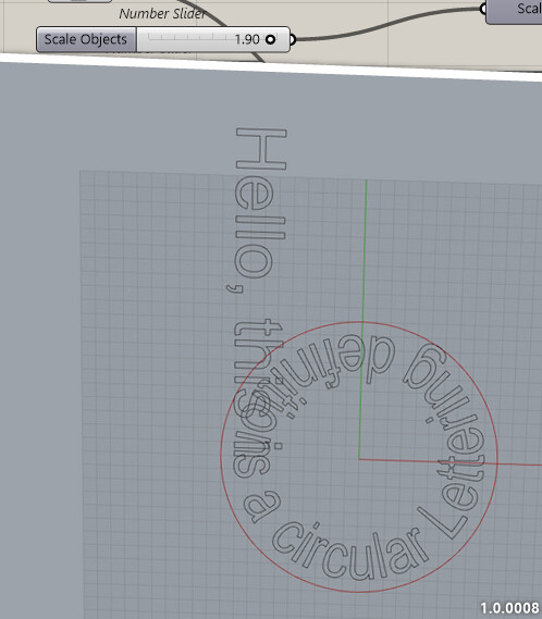

Edit, I never thought of doing vertical text, that is very cool!

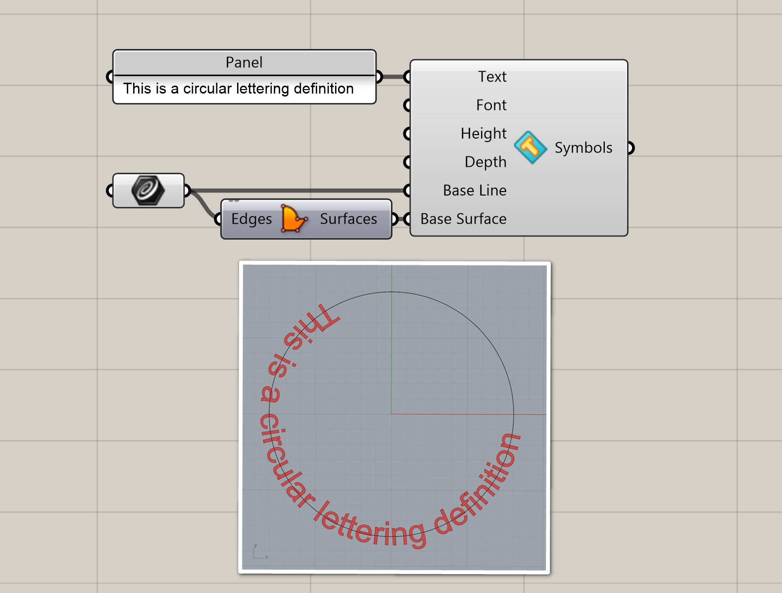

You can do this with a single component. Have you tried using the Text On Surface component?
TextOnSurface.gh (9.5 KB)
Honestly? I did not even know it existed. Interesting. Played with it a tiny bit, but it would still need a lot of extra “post processing” to get it doing what I want, the way I work.
For instance, when I am doing an emblem or badge I need to be able to rotate the text around easily and with a fine adjustment. It is also handy to be able to attach symbols, eg. a star to either end of the text. Then there is the whole moving it up and down relative to a baseline to get a “just right looking” fit. And there is also the “taper” effect. Some text looks good with a slight bit of taper, sometimes not.
Right now, that script is pretty much doing exactly what I want.
