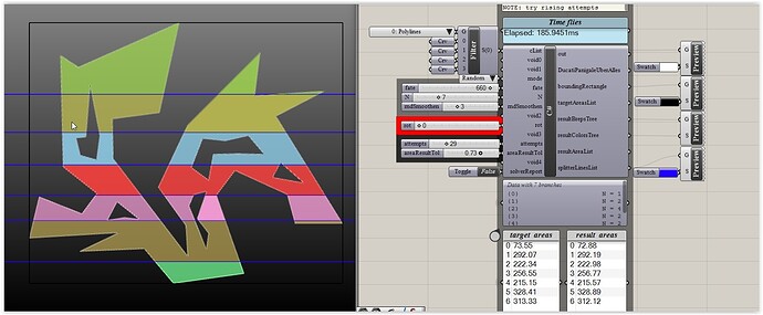

Found 5 minutes (with stuff already on hand like K_Means, Thiessen Polygons etc) to test the approach as exposed here: (RndPts > K_Means > centers > Thiessen > … etc etc)
Results are rather pathetic/“optimistic”. Wonder who had that idea.
On the other hand this C# works 100% (a Recursive Bouncy Solver that splits a BrepFace according a predefined List of Areas (random or not) on a per “stripe” pieces Area sum basis. That said this is written for entirely different purposes.

Update :
Good news: did some mods (still WIP mind) related with rnd Split direction and the thing did the trick.
Shown a circle for clarity - last piece [the Red: double the target Area size] not done/splitted for testing some Recursive stuff under investigation [i.e. Split phases for more “homogenous” BrepFaces].
Using a classic bouncy solver as the other cases posted above.
Bad news: used Methods that are - more or less - strictly internal.
At least, it proveds that the problem is indeed very hard. Thanks a lot!
Not that hard … but certainly tricky: bounce solvers are nasty animals.
Imagine a Method that starts from some value - that is implicitly extracted on the fly - and a resolution step … targeting some value (the piece target area). Then it loops (grow while is smaller or srink while is bigger). Each time that a grow/srink switch happens the current step is half the previous. The search stops if the target is “near enough” according some areaTol reasonable value.
For the core of the matter (switch grow<>srink) a classic bounce logic is used:
