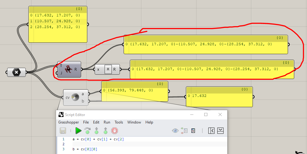

in the expression component, how can I indicate/recall an item from the point list in this case
ex: I would only need the cv0 or cv1 or cv2 or add them as in the photo?

No, it’s not the only way. Standard GH components like List Item will give you specific points. It depends on context?

returning to the question in my post, apparently either I wasn’t clear enough or you didn’t understand the question, what I would like to achieve directly within the expression component is what I was able to do with the Python component by setting input cv as List Access which would be this:
a=cv[0] in the case of the first point
or
a=cv[1] in the case of the second point
or
a=cv[2] in the case of the third point
I don’t know if it’s possible to do it and how, but from the solution you
posted using the List Item I can deduce that the answer is negative.

and I am incredulous that after the initial question with photos, subsequently having posted the solution always with photos for the intent I wanted to obtain and again after the last nice full-bodied explanation given in the last post, it is still not clear to you that at that result I intend to get there without adding other inputs to the Expression component, so the solution you keep proposing to me is the way I don’t want to approach the problem but I intend to have the same result having only one input in the Expression component but being able to manage n elements as I published with the Python component.
purpose: since the input of n points is unknown, I don’t like that every time the item list changes I have to add/remove input to the Expression component, the same thing I would have to do to the List Item component. while I simply mean to change the expression l inside the same which in this case is identified as the solution in the Python component, so if you find a way to do the same thing using the Expression component then hats off :mortar_board:

I need to be able to manipulate the input values as desired, see attached photo, do sums between the points, extrapolate the individual coordinates, etc.
I tried combining the text of all the elements in a single line, but then I didn’t find a way to split into substrings using a separator, maybe if the split was feasible you could think of doing it
ps provided that the data can be managed not as text obviously. but I don’t think it’s feasible,
I’m convincing myself that using the Python component is the only solution for this.
