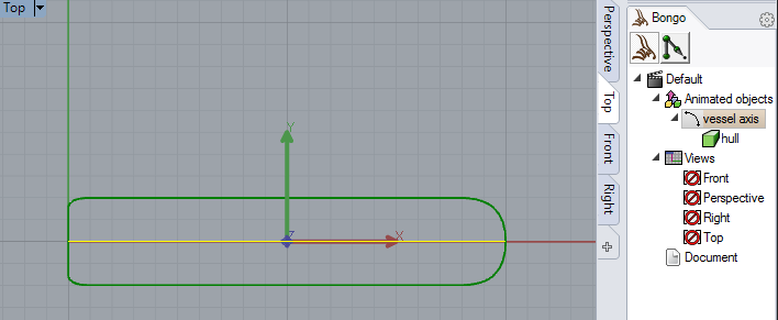

By default, the ‘hull’, child of the ‘vessel axis’ move with the ‘vessel axis’ but doesn’t rotate with it.
It looks me strange.
1 Design position:

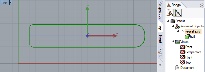

2 Moving the ‘vessel axis’:

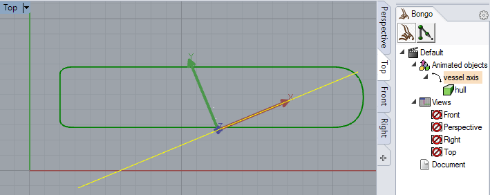

3 Rotating the ‘vessel axis’:
Hiearchy settings are set as default. I have tried to modify them but the hull still refuses to rotate with parent ‘vessel axis’.

Ok, now I’m able to reproduce it. I missed the last line in your first message.

Thank you for the model. I just answered you. You had one of the settings turned off and that’s why the child wasn’t following the parent.
:blush: I did checked the Advanced Hierarchy Settings of the children but not the top parent hierarchy settings. It was not clear for me that I had to check “Inherit settings from parent” in the parent settings so that child will follow parent’s movement. Maybe more info in the help file, an example, would help.
