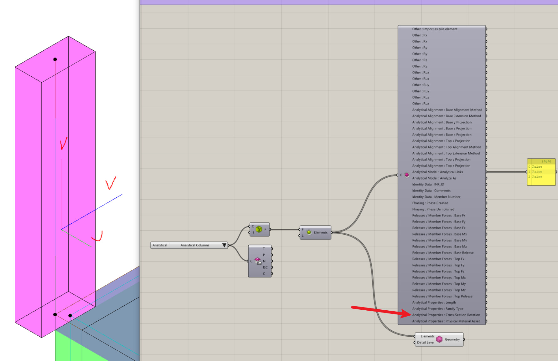

Can you please tell me how to change the directions of local axes of the column analytical model using rhino inside?

Hi, haven’t been working with analytical members but maybe you can try with the cross-section rotation parameter below?
Thanks for the answer, yes I understood you that it is possible to rotate the section
but I mean that I have for example columns not always vertical and I want to edit analytical local axes separately at least the local x-axis along the column to change up down
If you are trying to flip the X-Axis similar to Revit’s UI, then what is being done in the UI is flipping the curve direction, so you can do a similar process as shown below

I was testing on revit 2025, which version are you using?… Also maybe the analytical member is associated (not sure just guessing since i haven’t used it before)?
Also, in Revit 2024 the flip axis option wasn’t there in the UI when i was testing, so maybe that could be a reason if you are on ‘24? (Just thinking outloud since i am not on the laptop)
I have version 2022, I have to install a new one.
