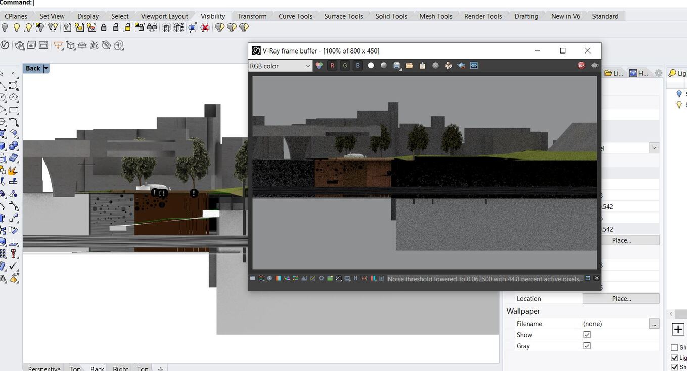

hello i’ve tried to render my model but some parts can’t be rendered from perspective view but i can render these objects from other views. why is this happening i checked all the layers and there isn’t a layer i pointed out in the pictures but it looked like there is a layer on the perspective view.

Have you tried rendering in a named perspective view?
Does it render correctly?
Is it probably because of VRay’s infinite plane?
Looks like the Rhino groundplane is enabled. You find it here:
