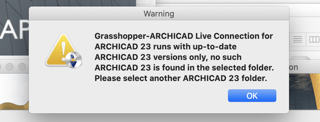

my one shows it only runs with up to date archicad 23 but I just download the latest edu version of 23. Do u know how to solve it?
 ![截屏2020-05-20 下午5.09.20](https://global.discourse-cdn.com/mcneel/uploads/default/original/3X/b/a/ba238a4548fd3b9d076bb6f51c603bc984b66735.png)

> [@liuxiao24](#):
Hi - you will need to contact Graphisoft for this issue.
