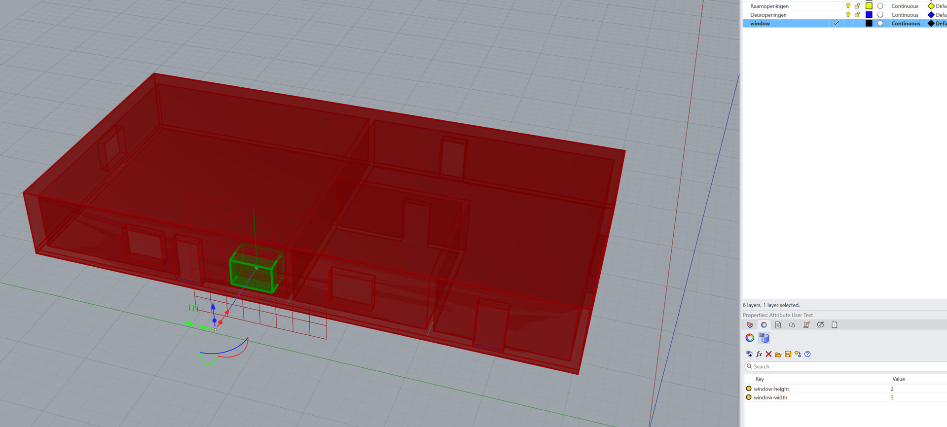

I would define a window with a point in Rhino and find the closest point on the building and then. The window size can be saved in the user attributes of the Rhino geometry. This allows quick changes without having to manipulate a lot of sliders in Grasshopper.
How do I create a window from a point? I don’t quite understand what you mean by user attributes yet.

The points need the user attributes so the box in Grasshopper has the right size…
Test model binnen en buitenwanden user text window 8.3dm (43.8 KB)
Where do i find the user attributes?
Select an object, go to the properties tab. It’s a blue barrel shaped icon

I see now. Thanks for the help! I can change the size of the object now. Is there also an option to change the location of the box?
With this approach you’d move the points in Rhino to change the location for each of the windows.

I made this for the doors. What am i doing wrong here? I constructed the same thing that you did
The panel with the string ‘door’ contains some whitespace
And only one of your two points in the layer door has attributes.
